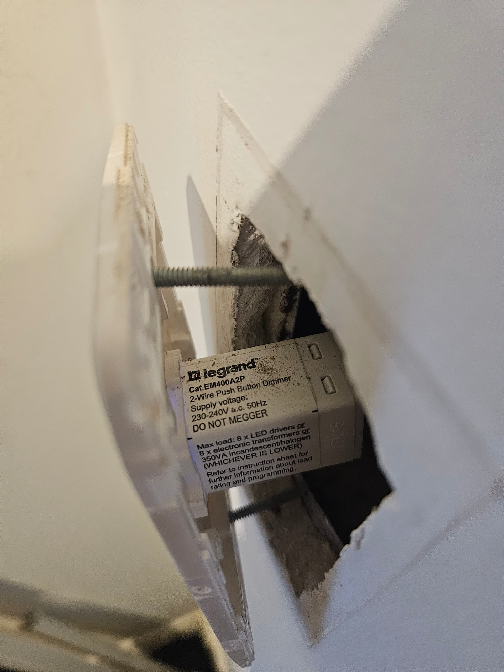

I have just moved house.
Most of the lighting is controlled by legrand push button dimmers.
I think theres a zigbee and/or netamo drop in replacement but im a little confused.
Anyone else got these and has upgraded them for control in HA?
Edit: I would also be open to putting a puck type device behind the switch, as long as it retains the button and doesnt require a neutral. Some of them have 2 dimmers already.

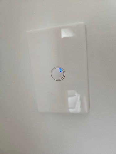

I dont really want to change the face plates. They are currently Legrand Excel Life, which of course have round switches not the standard shape.
Have a look at candeo or inovelli blue. I can’t suggest further because inovelli web-site is intolerable for me.
Another option (my choice), use dumb momentary switch and Shelly Dimmer2 or something similar.
