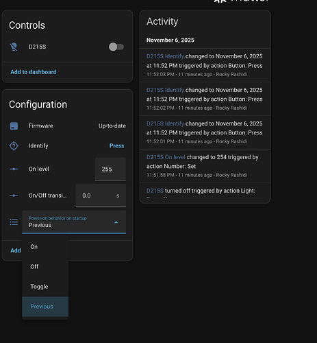

i just added a leviton smart switch D215S, using the matter integration in HA. Attached is a screenshot of the configurations . This is a switch and not a dimmer.
is someone able to explain to me
  1. what does “on level” mean?
  2. what does “power on behavior on startup” mean?
Power on behavior = Easier to think about it like you are turning the electric panel breaker to the switch on and off and what happens to load (light bulb connected to the switch).
  1. On - When power restored to the switch the load state will always be On
  2. Off - When power restored to the switch the load state will always be Off
  3. Toggle - when power restored to the switch the load state will be the opposite of whatever it was when powered off.
  4. Previous - When power restored the switch the load state will be the same as it was before power off.
On Level - not sure this does anything on the non-dimmer.
thanks so much. You have any idea what randomization means?
Where do you see ‘randomization’ in the d215s config? Not sure the context of your question.
