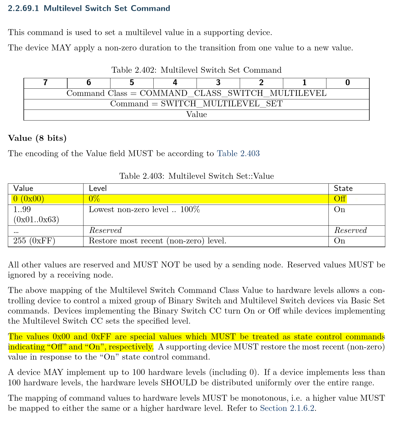

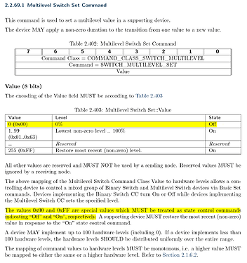

When HA sends the off command, Z-Wave JS logs: calling SET_VALUE API MultilevelSwitchCCAPI: property: targetValue, optimistic: true. This is the only behavioral difference between an HA off and a wall off at the Z-Wave level. The wall off produces no outbound command at all. The switch simply reports its own state changing via unsolicited MultilevelSwitchCCReport frames with targetValue: 0.
So the switch receives two different signals for “off”: an explicit MultilevelSwitchCCSet(0) from HA, and nothing from a wall press (it just self-reports). The restore behavior differs depending on which path was used.
Per the spec
Table 2.403 designates 0x00 as a state control command indicating Off, not a level assignment. The switch should preserve its last non-zero level regardless of how it received the off signal. When turned back on via the physical paddle after receiving MultilevelSwitchCCSet(0), my ZW6HD reports currentValue: 1, targetValue: 1 every time. When turned back on via HA (0xFF) after the same command, it correctly restores to the prior level.
Device details
  • Switch: Leviton ZW6HD (x67 units)
  • Firmware: 1.1.0.9 (latest available, released September 2025)

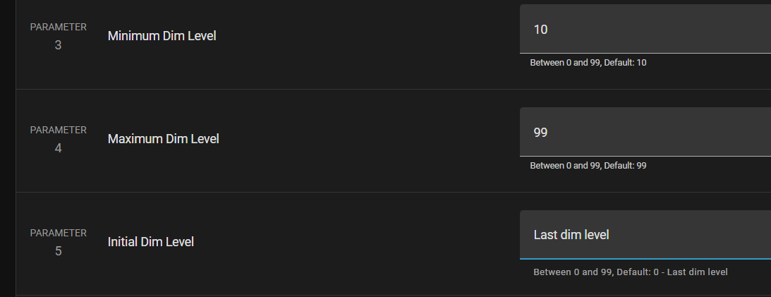

  • Configuration Parameter 5 (Initial Dim Level): set to “Last dim level” (default)
  • ZW6HD does not advertise Basic CC or Binary Switch CC, only Multilevel Switch CC
Question for the community
The spec is clear that 0x00 MUST be treated as a state control command, not a level assignment. The switch correctly honors this when HA sends 0xFF to turn back on, restoring the prior level. But it does not honor it when the physical paddle is used to turn back on after receiving 0x00 from Z-Wave JS.
This leaves an open question: is there a way for Z-Wave JS or HA to send the off command in a way that the switch’s internal paddle restore path treats identically to a local wall off? Other manufacturers’ dimmers apparently do not exhibit this split behavior. Has anyone seen this specific issue with Leviton dimmers, and is there a known workaround at the Z-Wave JS or HA configuration level?

That maybe could indicate that your configuration is set to go that level VS previous setting.
I wonder what I'm missing. Here's my configuration.
