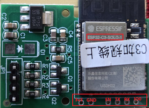

How it works: the Classic 300S has two separate MCU on the appliance board. One “control” MCU for sensors, mist output, front-panel buttons/display and a small WiFi daughterboard (eith an ESP32-SOLO-1C or ESP32-C3-SOLO-1, depending on when yours was made) that talks to the “control” MCU over a proprietary UART protocol (A5) and to VeSync’s cloud over WiFi. This project only replaces the WiFi module’s (ESP32) firmware, the control MCU is untouched, still gets the exact same UART commands it always expected, and the front panel keeps working exactly as before. It’s a straight firmware swap: no modificiation on the appliance board, no wiring changes to the mist/sensor hardware, no 3D-printed parts.

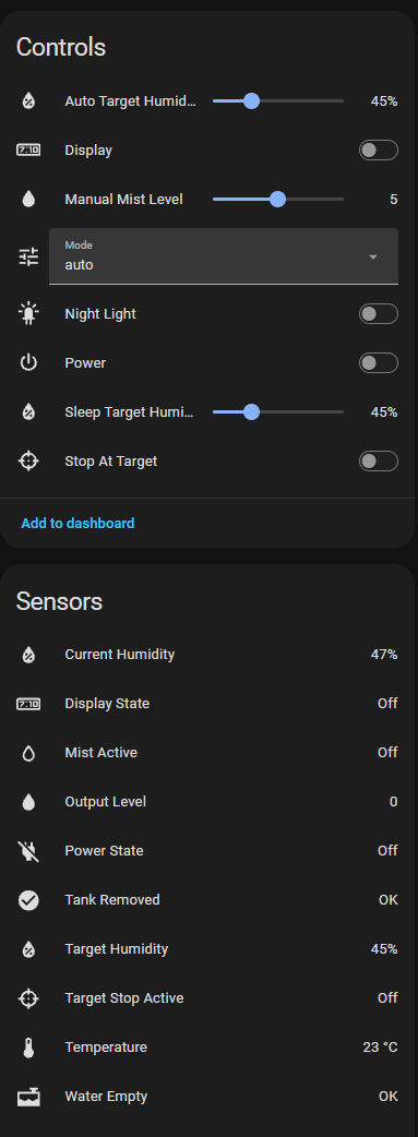

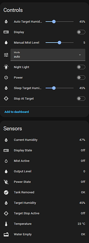

What you get:
  • Sensors: current humidity, target humidity, temperature, night light level, output level
  • Binary sensors: power, tank removed, water empty, mist active, display, target-stop-active, needs cleaning, replace water
  • Switches: power, display, stop-at-target, plus two independent Night Light notification switches
  • Numbers: manual mist level (1-9), auto target humidity, sleep target humidity
  • Select: mode (auto / manual / sleep)
  • Light: Night Light as a real dimmable light entity, which can also double as a status indicator: flashing on Water Empty/Tank Removed, slow breathing pulse while misting, fully configurable/optional/experimental

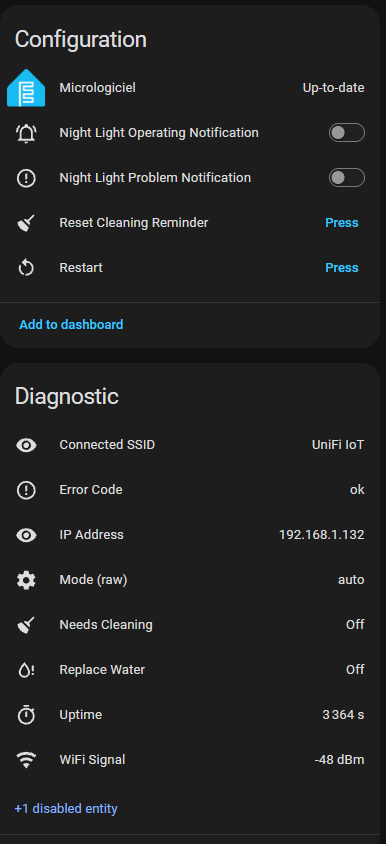

  • A restart button, a cleaning-reminder button, and automation triggers for the physical power button’s long-press events

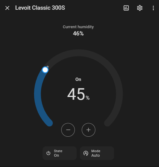

Since the raw entities land as separate select/number/switch (HA core has no humidifier platform for templates), I also built a small companion HACS integration, levoit-classic300s-humidifier-bridge, that combines them into one native humidifier card, set up entirely through the UI (auto-detects your device’s entities, no YAML). Totally optional, the raw entities work fine on their own.

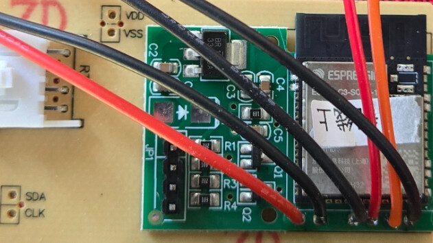

Before you dive in: this requires opening the unit and soldering temporary wires to 6 unpopulated pads on the WiFi module (3V3, GND, EN, IO0, RX, TX) to flash it over serial the first time, after that, updates are OTA. Not a beginner-friendly weekend project if you’ve never done UART flashing before, but nothing about it is destructive to the appliance board, and the README walks through backing up the stock firmware first so you always have a way back to stock.
