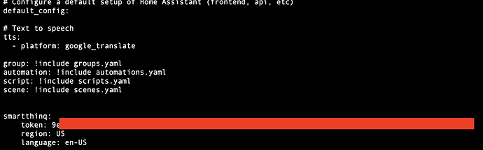

After grabbing the refresh token the configuration.yaml file looks like this
Home assistant was rebooted and nothing came up. The next thing I tried to do to troubleshoot was switch out the wideq api v1 and apiv2 repositories and replace the refresh token in configuration.yaml. No dice. I have switched it back and here we are.

@MrPotshot - no way, im actually a network engineer too! :slight_smile: first thing that jumps out at me is your directory structure is wrong (if i understand your snip correctly), smartthinq and wideq need to be under custom_components i believe. At least they are for me.
Then after that, and a clean boot, mine just sprung to life - specifically i could see climate.XXXX (XXXX is what you name the device in your LG smartthinq app - for me its ‘air’) so i get the following in developer -> states:
what does your boot up look like? mine looks like this (i schedule a nightly reboot of hass at 1am) - pretty clean in the logs from a smartthinq point of view just one warning (and some other failure at 5am for some other reason - shitty LG API i guess), and then if i look for climate.air in the same log, i get the occasional warning its taking > 10 secs to poll the API (again, same reason!).
Hopefully this gives you enough of a comparison point to crack your problem.
