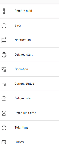

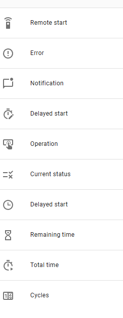

The entities are:
I believe I have it fix by looking at notification and a state change. I’ll know for sure next load of wash.
Current status should tell you if it’s running or not.

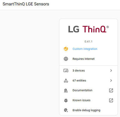

You want to go to developer’s tools → states and find the exact entity name for the washer.
I do not have a binary_sensor. for my washing machine. Did I miss something on the integration? I am going to try to trigger on events as suggested above. SO far it has not worked, but hopefully I will figure it out.
Do you have this integration?
@stevemann that looks like a custom component - the core LG uses events and doesn’t supply the binary sensor you describe.

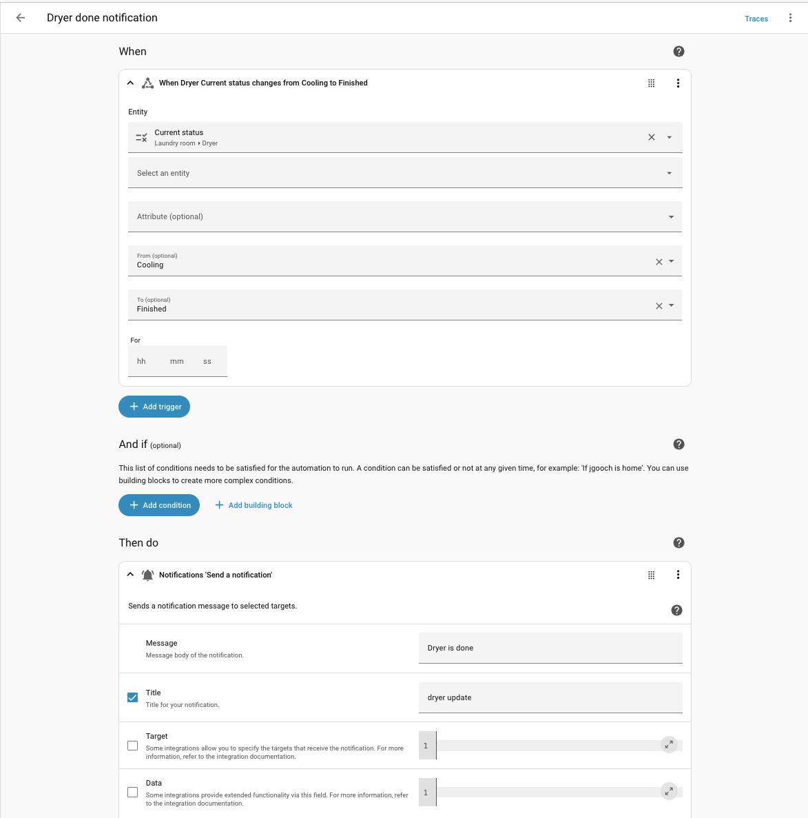

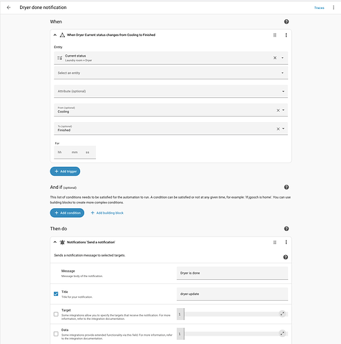

You can automate notifications from the GUI if you don’t want to mess with editing YAML.
Here is my “dryer done” automated notifications. It pops a notice up on my phone.
