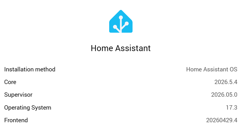

Do you know which version you were using before? What HA Core version are you on? Did you do anything besides updating the Life360 integration and just restarting HA?
To my knowledge, and in my experience, it should have just continued to work as before after updating. I am running 0.9.1 on two instances (running HA Core versions 2025.12.5 & 2026.5.3), and both are working fine.
I'm almost 100% sure the previous version was 0.9.0?
There where a few other updates pending the same time i updated Life360, mostly random card updates and atomic calendar.
