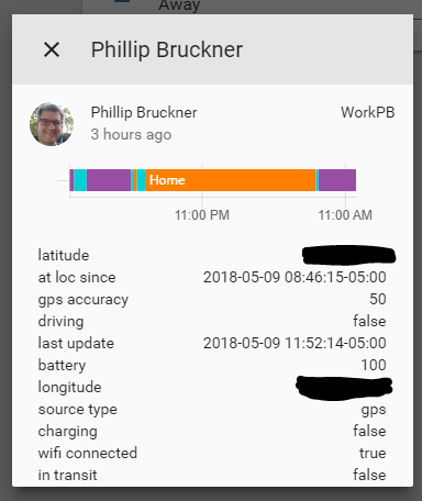

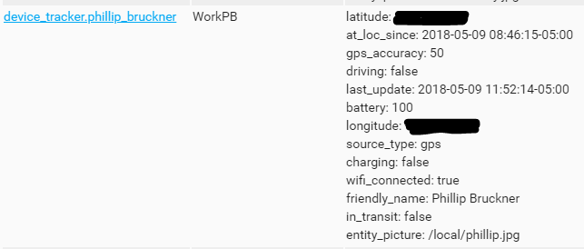

Regarding displaying/seeing them in the “frontend”, well, you can see them on the States page:
And you can see them in the entity:
Those are both stock HA things.
