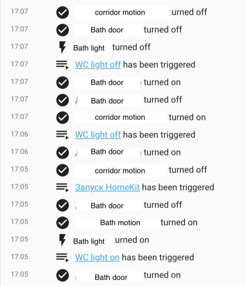

It didn’t work correct:(
I open the door - lights turn on. Then I close the door, open, close (nothing happens) and then I open it again and lights instantly turn off
