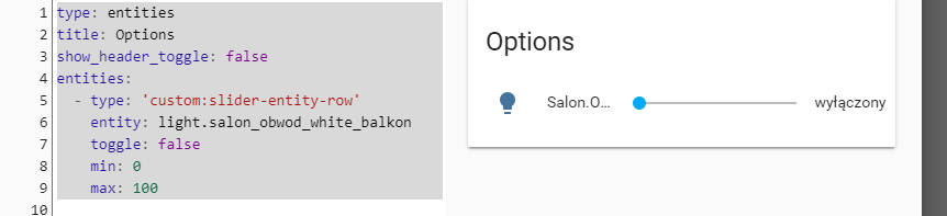

the slider is now working almost so like i need. in this case i have question.
if the slider is on 0 value then i have information on or off
is possible to have there value 0%?

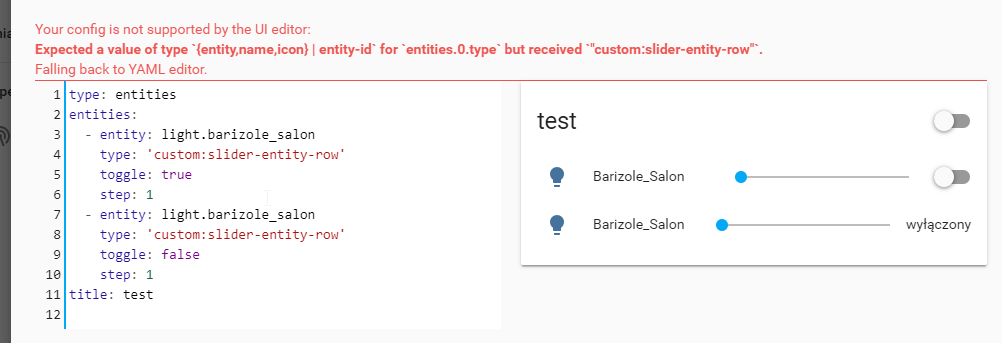

i have created a group so like You send me the link:
on main page i have pin up the element two times
code:
but in case of using the switch on right side of slider i have still problem :confused:
i have something like this
but at switching it is not running, if i change to toogle then it’s running but what about state (on - last value / off - 0)
second question. if i have the switch to off and slide something then the light is reacting on it but the switch has off state. if i turn it on then if i have some value on slider then he goes to 0.
