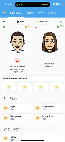

Just a simple question (not for me tho) … when I select the light in the mushroom template for the 4 icons, the light turns on off which is great. But how can I get it to show or turn a different color when it is off (or on)?
heres the current code
type: horizontal-stack
  • type: custom:mushroom-template-card
    primary: ‘’
    secondary: ‘’
    icon: mdi:home
    icon_color: amber
    layout: vertical
    picture: ‘’
    entity: light.house_lights
    primary: ‘’
    secondary: ‘’
    icon: mdi:home-floor-1
    icon_color: amber
    layout: vertical
    tap_action:
    action: navigate
    navigation_path: ‘’
    entity: light.downstairs_lights
    primary: ‘’
    secondary: ‘’
    icon: mdi:home-floor-2
    entity: light.hallway
    icon_color: amber
    primary: ‘’
    secondary: ‘’
    icon: mdi:home-floor-3
    icon_color: amber
    entity: light.office_lights
    fill_container: false

if i hold the button, a blue circle pops up and then it goes into the light options (i.e. color, effect, etc.)
Isn’t that what you were looking for?
hmm, looking for something to indicate that the light group is in an on state or off state.
If its off, then maybe the house floor icon lights up as gray.
if its on, then the house floor icon lights up as amber.
