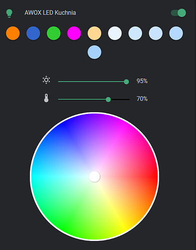

Zrzut ekranu 2021-07-17 153247
The newest version added support for the new color_modes attribute as a fallback. I’m seeing WLED entities that still use the old supported_features attribute (which is fine) but that value does not add up to say it supports color wheel. supported_features & 16 is the operation to see if your entity supports color wheel. If this returns zero then according to HA, that entity does not support color wheel.
Not sure if there’s something you need me to confirm or what here. The card was displaying the color wheel fine in WLED version 9. I tried backing WLED down to version 12 to no avail. If there’s anything I can do to help, please let me know as I miss the functionality of this card.
can you paste your entity’s attributes?
Interesting the color wheel show here
