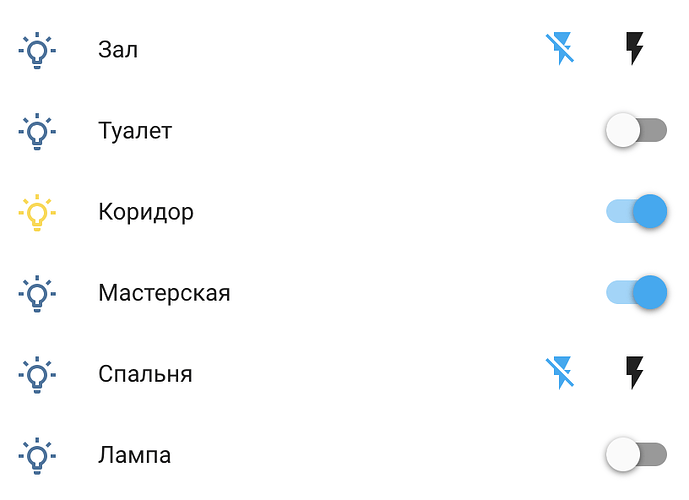

Greetings!
Got aqara switches, playing with them a bit. There are two channels in my room, but I want to use one button for them, so I made a group (so I still can sometimes use just half of the lights).
But now left bulb icon does not fire when group is turned on.
How can I mannage that?
Have a nice day!

Is it possible to have one button to two switches (like it is right now) and to have 2 switches when I open it up? So, in main card I see one switch for group, but if I open that group I can choose whitch one I want tu turn on.
petro
(Petro)
October 11, 2018, 12:04pm
9
I don’t think that’s possible without a custom ui.
Tinkerer
(aka DubhAd on GitHub)
October 12, 2018, 6:37am
10
As @petro said - that’s only possible with a custom UI
