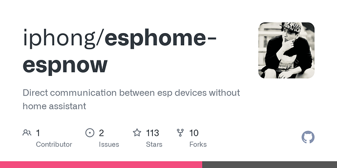

I wonder if it would be possi le to do espnow to control the bulbs while still keeping connection to HA?

Hi, this looks like another way of syncing your esphome lights similar to tasmota group
Does this also work for adjusting brightness & colors?
Should be yes. But the custom component your are linking regarding esp-now is abandoned since a long time. Instead check out the more recent work from @tomrusteze :point_down:
