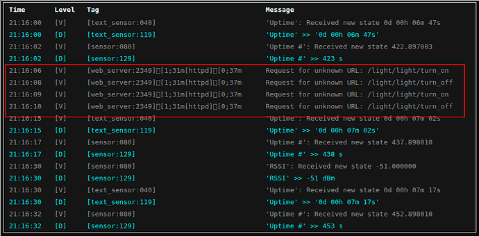

This is a screenshot from the log of the receiving Sonoff device.

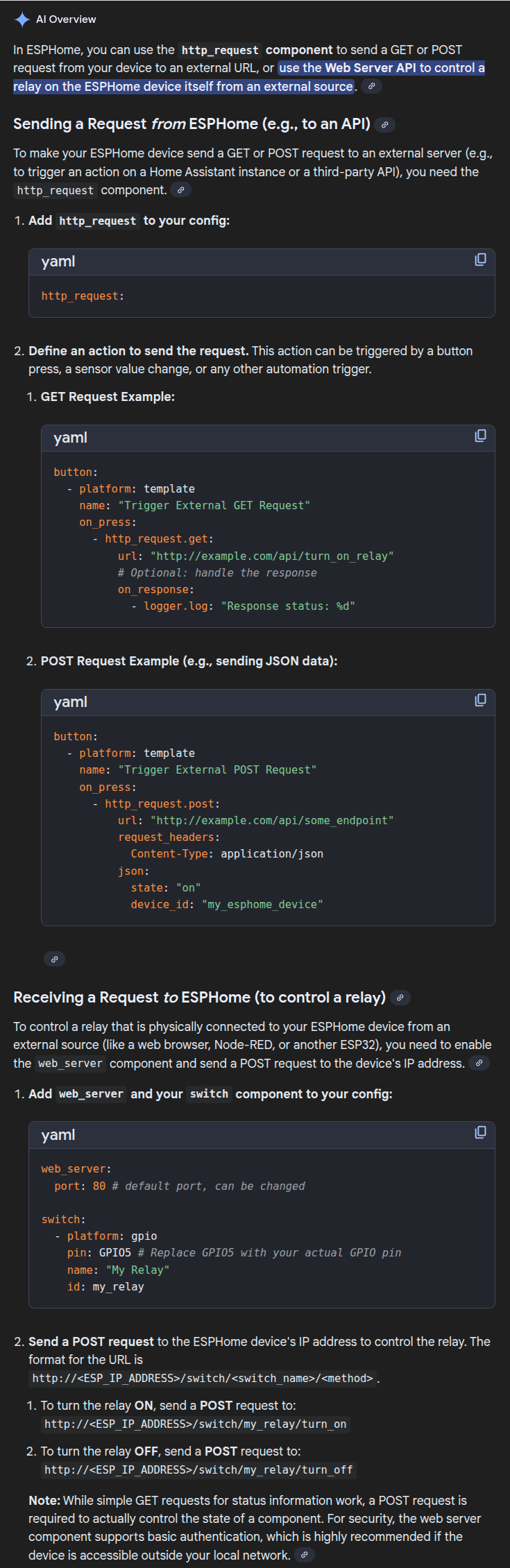

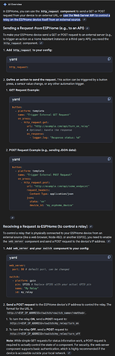

So for anyone that stumbles on this, I found my working solution. Apparently with the recent changes to ESPHome, in order to do actual device control, ESPHome requires that to be done through a POST request. You can no longer do it through the simple GET request method that I was originally using. I found this info through a google search and this is what the AI posted. I have it as a screenshot because I couldn’t find a single URL with this information.
Here are the changes I made to the YAML code to send the POST request. This code has been tested and is verified as working.

OK, slight correction. After installing the above cod, it did wor, however after looking at the loga on the Sonoff as I was pushing the buttons, I noticed it was saying that the JSON headers were incorrect and that the URL format of “/light/light/turn_on” was depreciated. It said to use the entity name instead which is ACTALLY, “/light/Light/turn_on”. Notice the capital L. So here is what is now working with no log errors.
