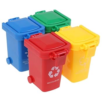

While browsing AliExpress I came across these cute miniature rubbish bins, and this got me thinking. Could I illuminate the bins to show what kind of rubbish to put out?
https://www.aliexpress.com/item/1005004186109110.html

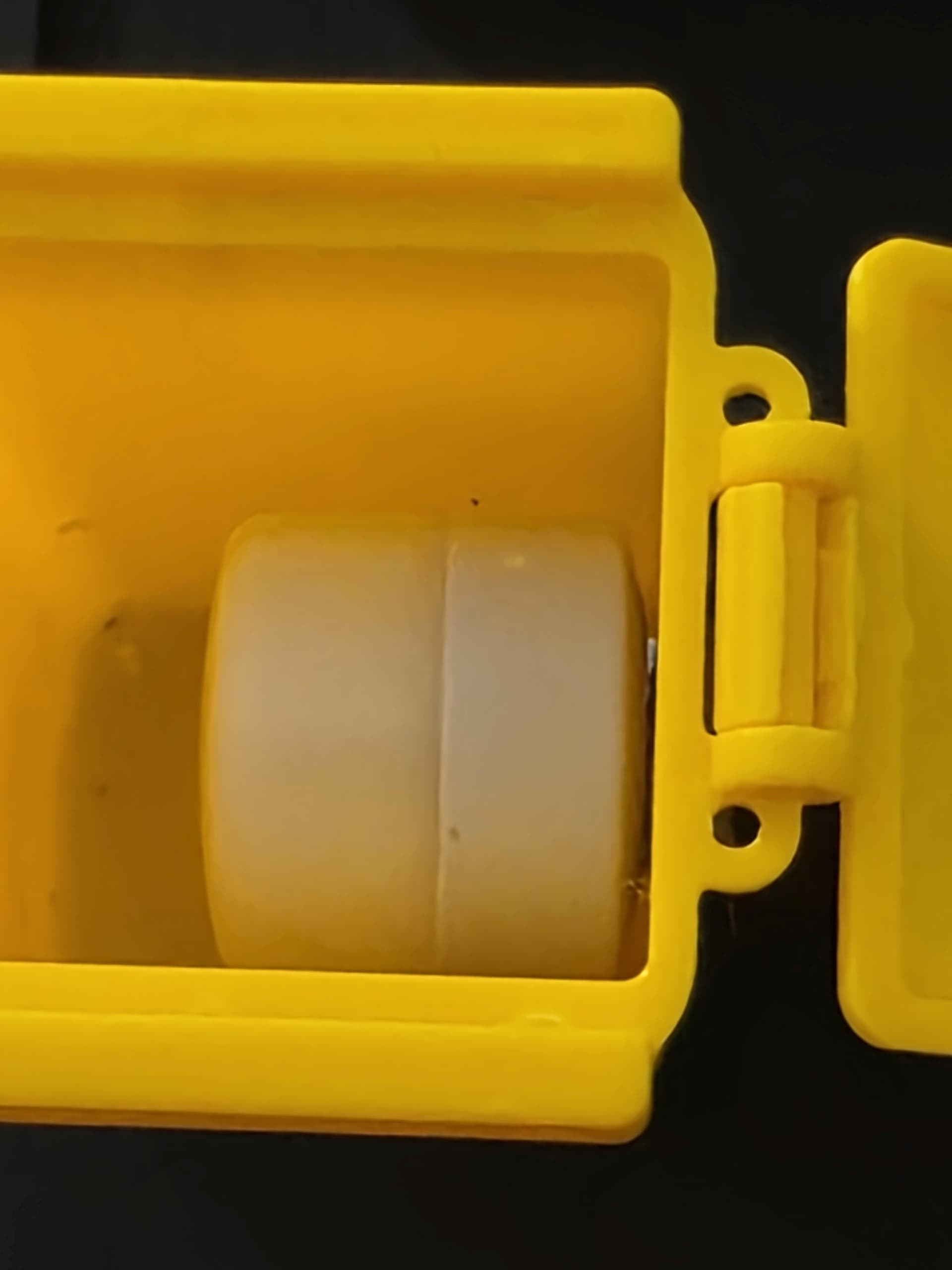

I cut a usb sized slot in the bins, pushed the lights in from inside the bins, and hot glued them in place.
So, here is the finished product. The lids can be swapped so that the bins match the actual bins in your area. Here in Auckland New Zealand dark green bins are used with red and yellow lids. The dark green doesn’t let the light through, so I went with lighter coloured ones instead.
