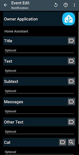

To make sure sounds are played for the alerts consistently I use tasker to set the volume on the phone, play the sound then mute the phone again using the title as a trigger.

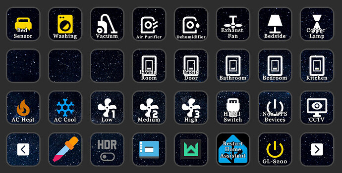

I also have a dedicated button to toggle it on and off as needed on my streamdeck xl:
