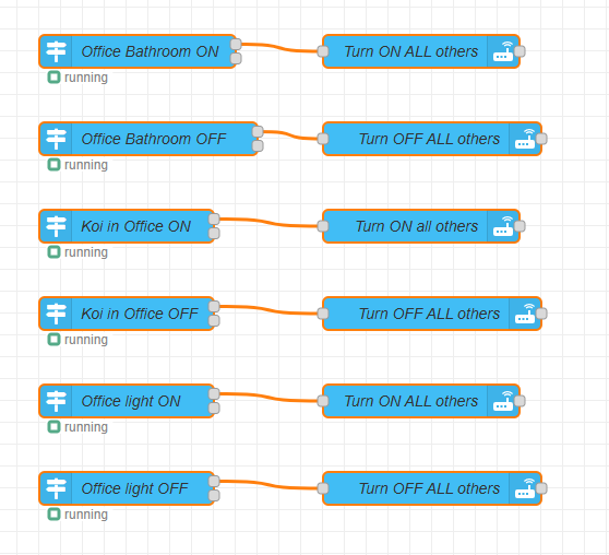

What’s the most efficient way to setup lights that have a master slave relationship eg I have 1 switch that controls the light (wired to the light) but I have multiple other “slave” switches that I want to control the same light via automation (not wired to the light). Each time I’ve set up a flow in node red it creates a loop. The loop eventually ends but I’d prefer to have something that doesn’t create a loop. Here’s what I currently have for 3 light switches.

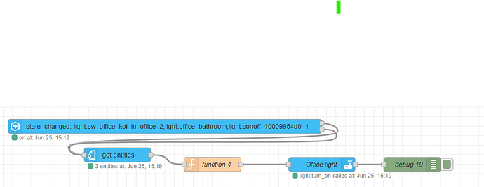

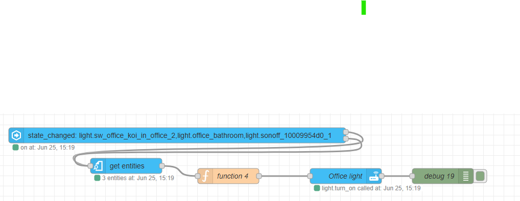

I think this is the best I can do with no loops.
Hopefully this helps someone given the amount of help I’ve received from this community reading old threads :slight_smile:
In short the solution is
  1. State change - list all entities where there can be a change as this is an “or” node
  2. Get entities - I used a group helper as this is an “and” node and you’d need either 3 nodes or a group and given I’ll have 4 and 5 way switches then this is probably the easiest. The entities need to be the same as in 1 above. You can’t use groups in 1 above as if 1 item is on in the group then the group is on so turning off doesn’t work.
  3. Function - Part a: Put all the entities through a function to compare their state to the state change and if the state is the same then exclude them from the output
  4. Function - Part b: Pass the turn_on/turn_off. This makes everything a variable in the action node. This means you only need to maintain 1 and 2 above.
  5. Action - empty as it gets everything from the function node

Note: the action node must have Block Input overrides deselected - it’s selected by default.
Here’s a new and improved version as I have lights.* for the main light and switch.* for the slaves. This allows me to use get entities for things like “turn on all lights” and therefore it won’t include slave lights. Of course you can use groups in the “get slave switches” when you need more - I just tested with “starts with” for a quick test
