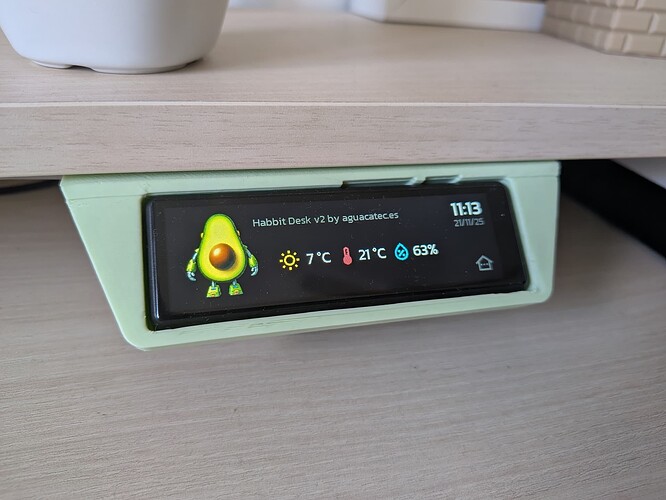

I recently got a Lilygo T-Display S3 Long screen, and although it was quite difficult to find documentation to get started with it and ESPHome, I finally created this device, which I’ve called ‘Habbit Desk’ (because it’s an evolution of the Habbit I made with the CYD).
Essentially, it’s a device designed to be placed under your desk to control Home Assistant. Below, you can see how it works, as well as the instructions and full code in the article on aguacatec.
I hope you like it! :smiley:
PS: Thanks to pixelwave for his project, which helped me get started and served as inspiration!
Nice!
How do you find quality of the screen? Is black good enoight, especially in night? Or just ugly greyish?
I haven’t tested It in the darkness :sweat_smile: i Will and let you know.
For now, i am very Happy with this device
