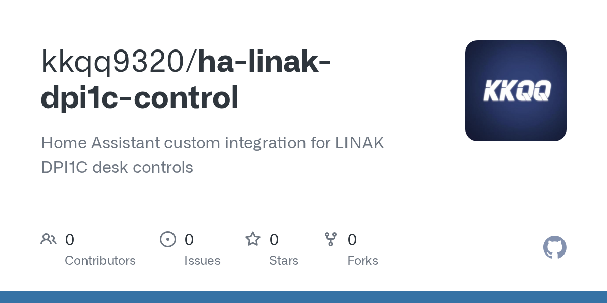

I created an unofficial custom integration for controlling and monitoring a LINAK DPI1C sit-stand desk panel directly from Home Assistant over Bluetooth.
GitHub repository:
Open your Home Assistant instance and add this repository to HACS
The integration uses Home Assistant’s Bluetooth APIs and has been tested using a Bluetooth Proxy with active connection support.

The integration can be installed as a HACS custom repository.
  1. Open HACS.
  2. Select Custom repositories from the top-right menu.
  3. Add:
https://github.com/kkqq9320/ha-linak-dpi1c-control
  1. Select Integration as the category.
  2. Download LINAK DPI1C.
  3. Restart Home Assistant.
  4. Go to Settings → Devices & services → Add integration and search for LINAK DPI1C.
It is currently available only as a custom repository and is not included in the default HACS catalog.
Manual installation instructions are also included in the repository.
