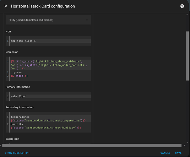

Hey all,
I’ve got the following in the Secondary information of a Horizontal Stack Card:
Temperature: {{states(‘sensor.downstairs_nest_temperature’)}}
Humidity: {{states(‘sensor.downstairs_nest_humidity’)}}
This wants to display all on one line, and I would like them one on top of the other. Is there a way to force a Carriage Return/Linefeed between them?
Thanks!

OK,
type: horizontal-stack
cards:
primary: Main Floor
secondary: |-
Temperature: {{states('sensor.downstairs_nest_temperature')}}
Humidity: {{states('sensor.downstairs_nest_humidity')}}
icon: mdi:home-floor-1
tap_action:
action: navigate
navigation_path: floor1
hold_action:
action: none
double_tap_action:
action: none
icon_color: >-
{% if is_state('light.kitchen_above_cabinets', 'on') or
is_state('light.kitchen_under_cabinets', 'on') %}
green
{% endif %}
layout: vertical
fill_container: true
primary: Second Floor
secondary: |-
Temperature: {{ states('sensor.upstairs_nest_temperature')}}
Humidity: {{ states('sensor.upstairs_nest_humidity')}}
icon: mdi:home-floor-2
layout: vertical
tap_action:
action: navigate
navigation_path: floor2
hold_action:
action: none
double_tap_action:
action: none
icon_color: ''

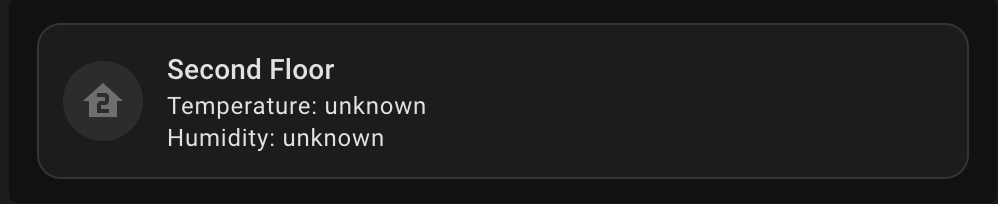

You can do it by setting the white-space attribute to break-spaces on the .secondary class, and putting a single return between the lines.
type: custom:mushroom-template-card
secondary: >
card_mod:
style:
mushroom-state-info$: |
.secondary {
white-space: break-spaces !important;
