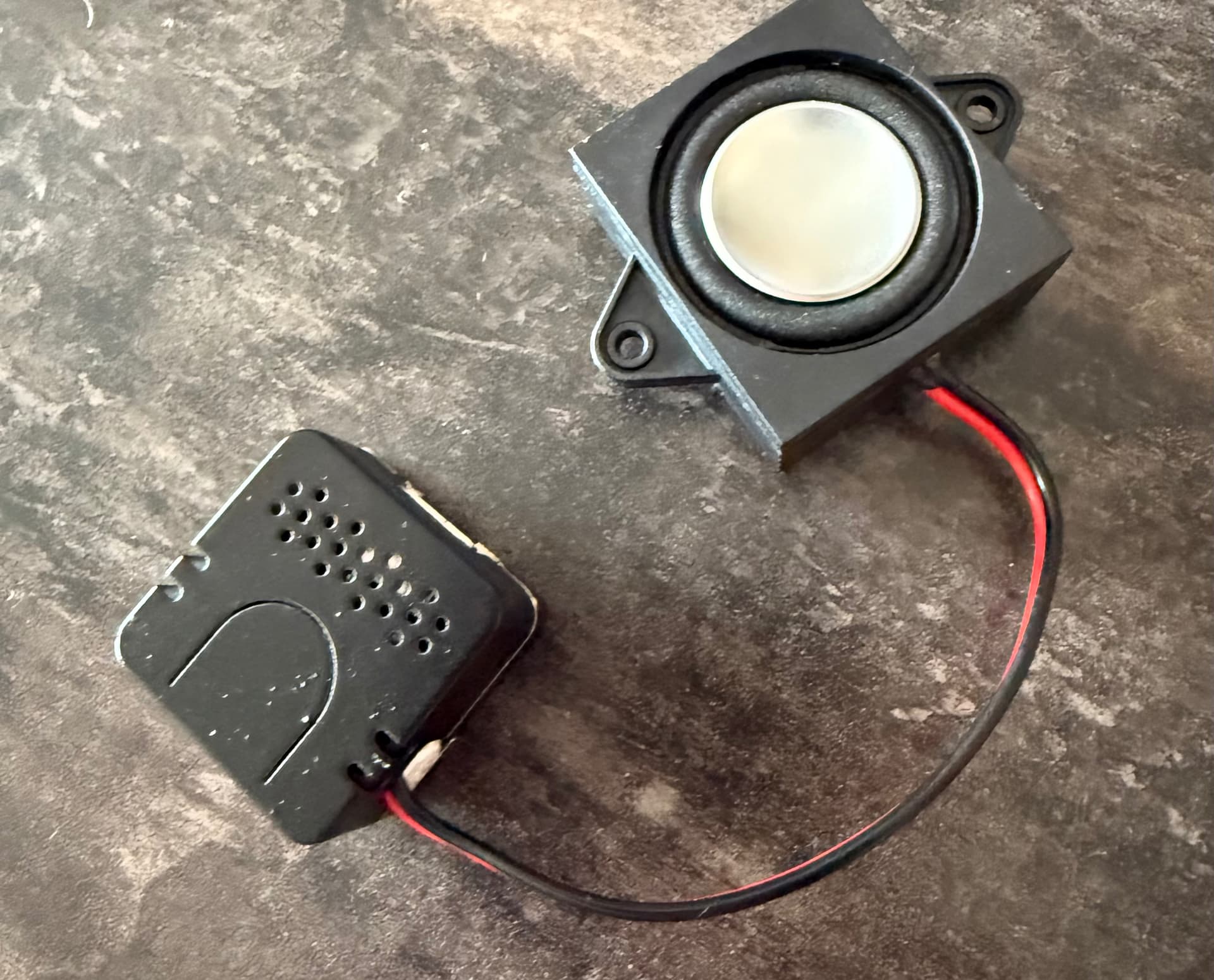

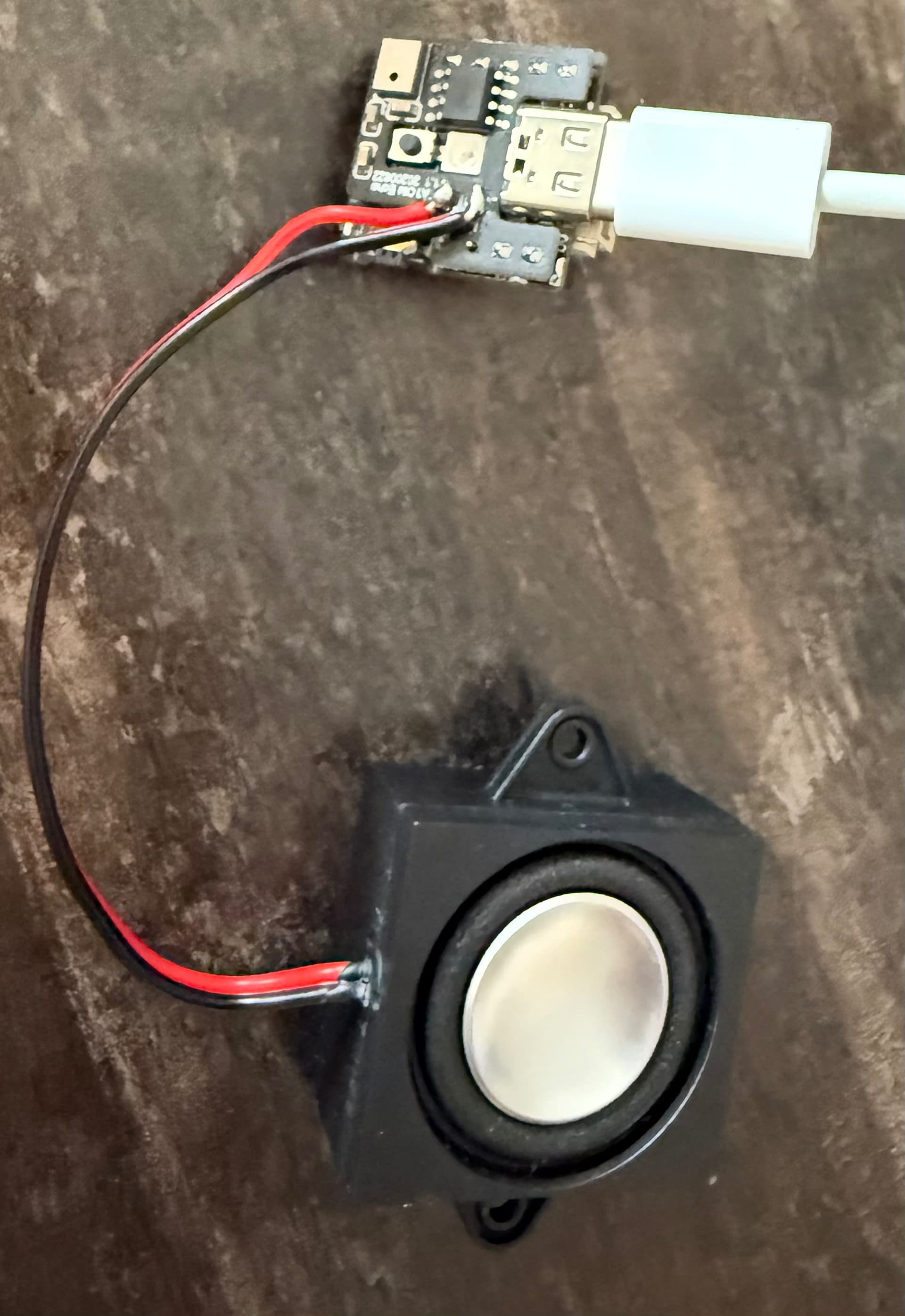

in the end I found my final configuration… the 8ohm 3W speaker gives a great change in the volume of the device making it decidedly very acceptable and functional for a room without adding other cables or complicated connections.
You just have to solder the two cables and the result is great (the speaker is the 8Ohm version posted above).
if you remove the Reset button of the case you can also unplug the wires and put the cover back on. (alternatively you can also connect two 4Ohm speakers in parallel to bring the resistance to 8Ohm for a more diffused effect)
