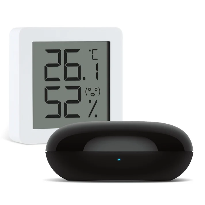

This flow will allow integration of the following:
- LinknLink eTHS2 (Bluetooth Temperature, Humidity, Battery & Status)
- LinknLink eRemote (Bluetooth Hub for eTHS - WIFI-Modbus into HA)
- Survives HA Host Machine Reboots.

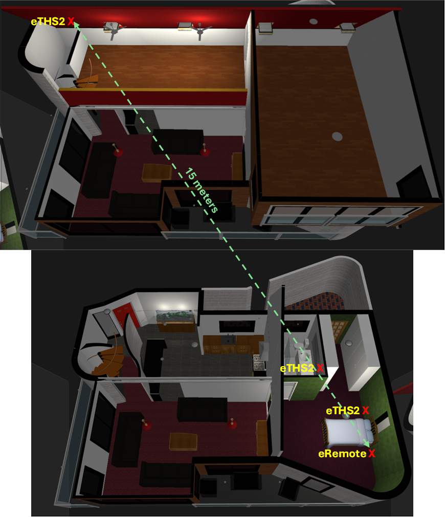

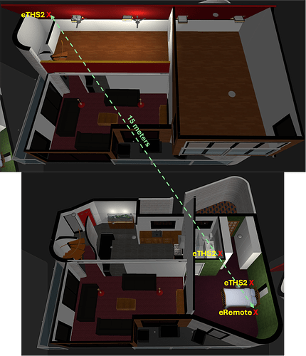

Confirmed working distance of 15m through two walls, between the eRemote and the eTHS2.
Seems to be very solid connection with two months of testing and very low power comsumption.
Even works inside the fridge.

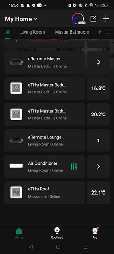

1. Add your eRemote to your LinknLink App
- Follow instrcutions in App
2. Update firmware of eRemote
- Go to the device page, click on the “…” menu > “Settings” > “Firmware Update” > “URL”, then paste the following URL: http://eufirmware.linklinkiot.com/firmware/eRemote-60868-8720-BL-3330.upd.bin
3. Connect your eTHS2 sensors to eRemote
- Follow instructions in App

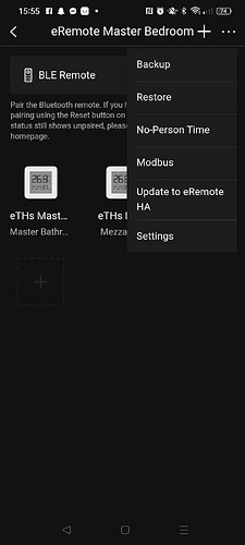

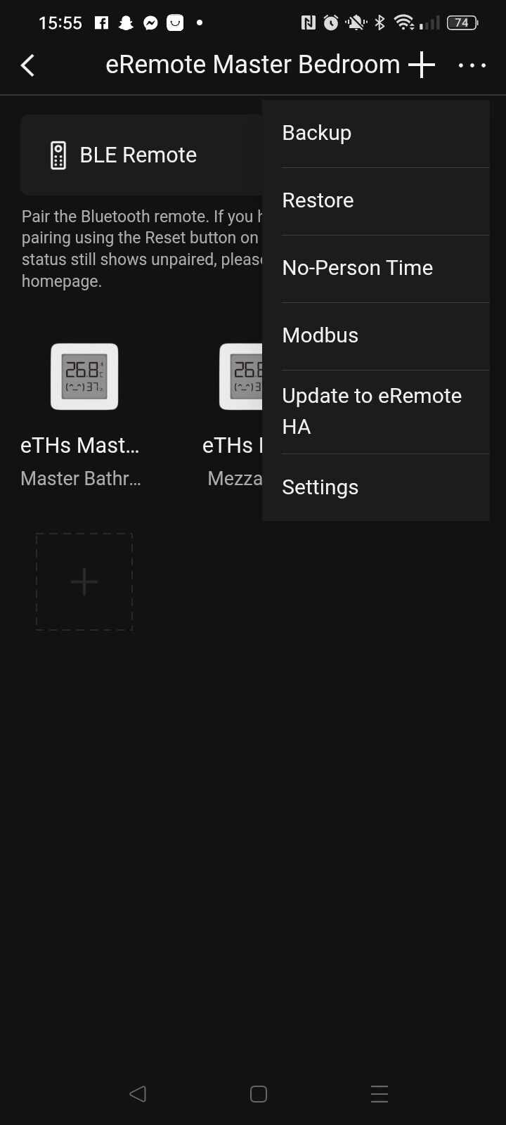

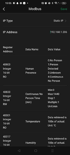

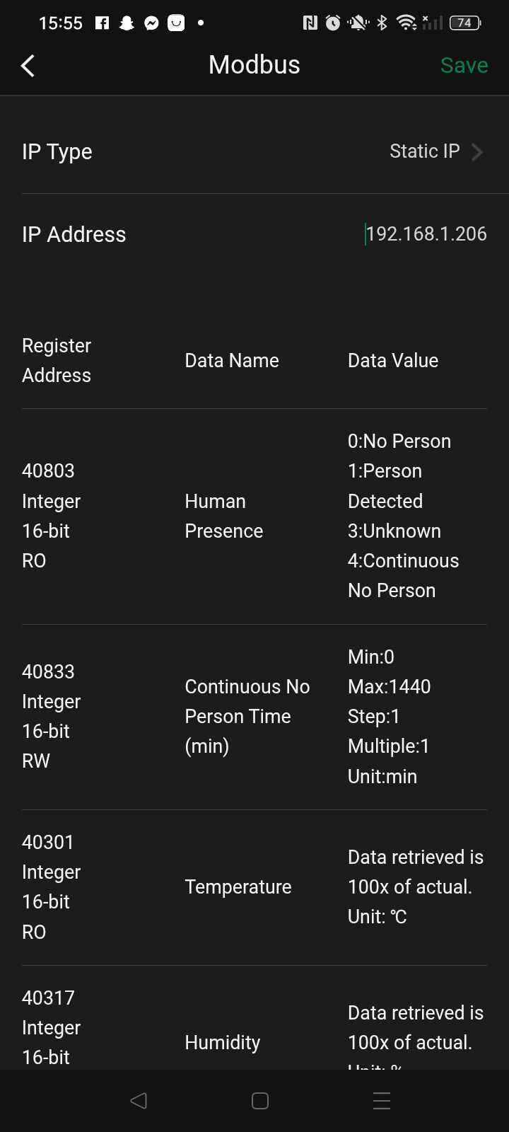

4. Setup Modbus TCP
- Go to the device page, select the eRemote connected to your eTHS devices
- Click the “…” → “Modbus” to set a fixed IP address (Host) for eRemote.

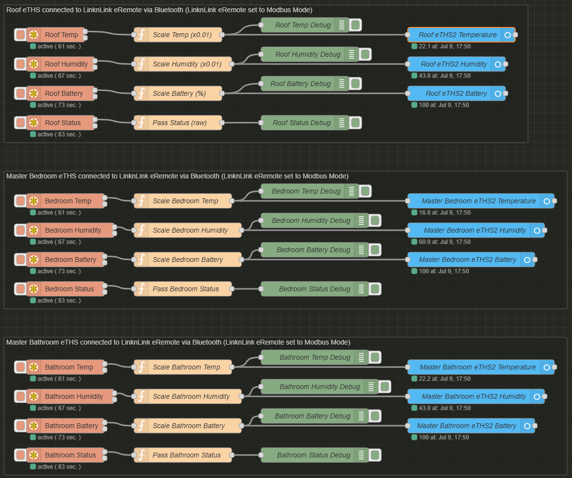

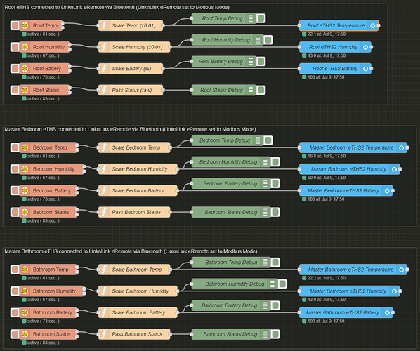

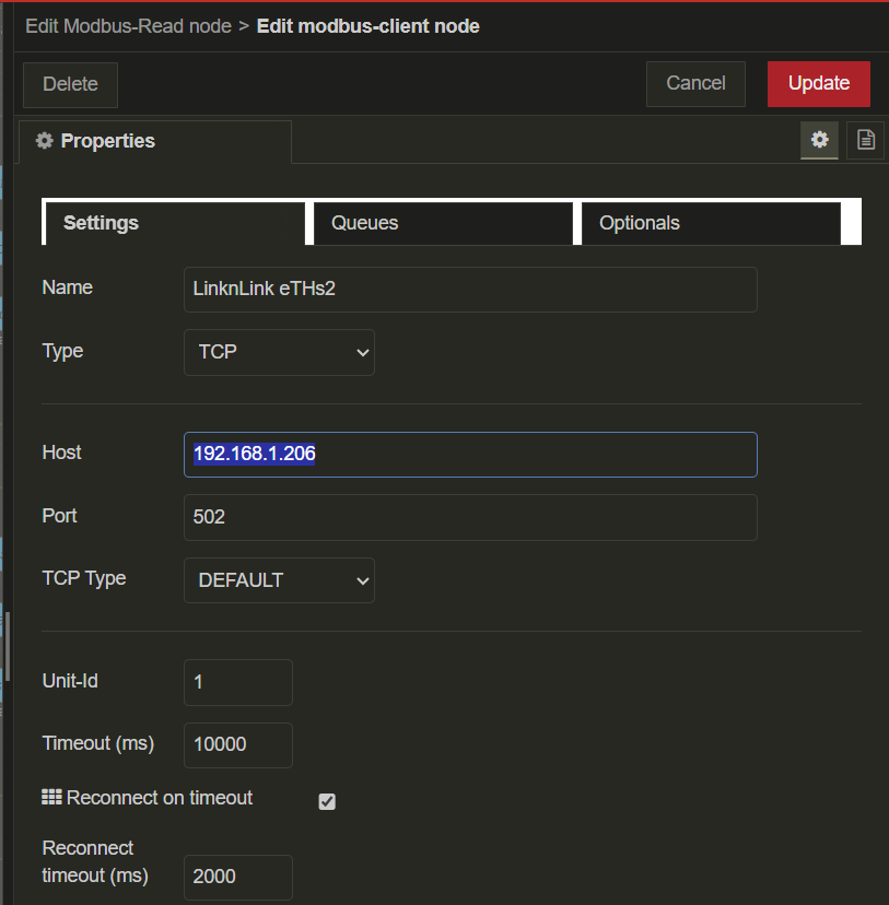

Configure NodeRED Flow

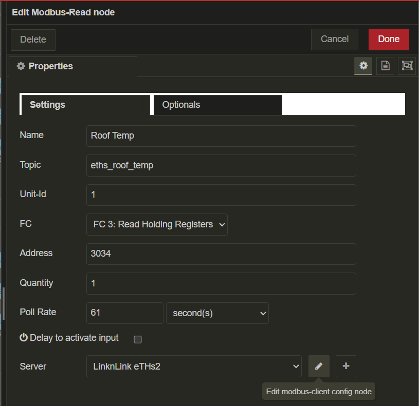

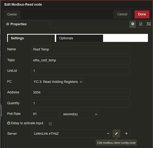

1. Update the Modbus-Read Nodes with your Server with the fixed IP address (Host) of your eRemote

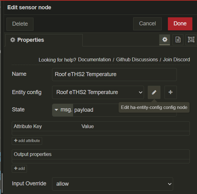

2. Update the Sensor Nodes, ensure your Home Assistant Server is added
.3. All should work and survive, Host Reboots, Node Red Restarts and HA Restarts
- Note the Poll times have been reduced to prime numbers (61, 67, 73 & 83) to prevent overloading the eRemote. You can adjust these to your liking larger numbers will reduce your database size. LinknLink defaults (30, 35, 40, 60)
