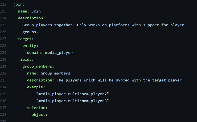

I’m creating a script that I would like to take a list of strings, in a similar what that media_player.join does for the ‘group_members’ field. How do you do that? I cannot seem to find a selector type that would do that.

Not sure what you want, can you please provide a “this is what I have” and “this is what I want” use-case?
So let’s say your script looks as follow:

What if I wanted the media_content_id to not be a single string, but instead a list / array of media content ids? I also want it to show up in the automation editing UI as a list, similar to the Group Members parameter in media_player.join service call. See here:

Thanks for the suggestion. I was going to consider that route, or something similar, if I couldn’t figure out how to get an array or list sent to the script. It has to possible in some capacity since media_player.join does it. I’ll see if I can find some reference in the source code in HA.
