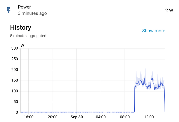

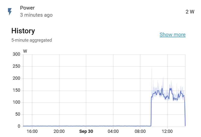

I have a SP-EUC01 from Aqara, it is connected to my desktop PC and reports around 2W usage when it’s turned off. I have a ESP32 plugged into the PC that is powered by those 2 watts.

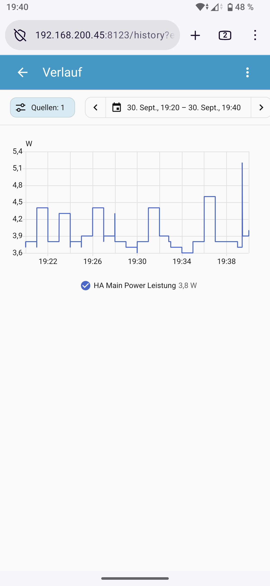

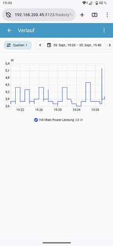

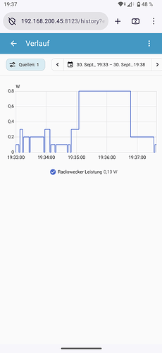

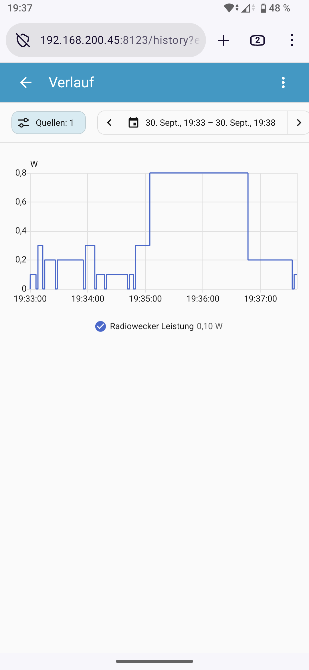

I don’t know about your local availability but I have several TP-Link Kasa KP125M that read down to at least 0.5 W. I even have an automation that reliably triggers when it hits 0.7 W and then again when it drops from 0.7 W to 0.5 W.

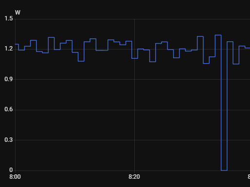

I have a few power plug energy monitors around the house and while they report low power consumptions like 1W I cannot say what the accuracy is.
Here is my TV while it is off:
So the inference is they have a resolution of about 0.1W.
