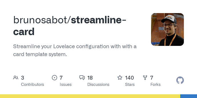

I managed to do it in most of the cases using streamline card

Check this out:
It can do most of what I needed
Yes but you lose the ability to edit the card with the UI.
