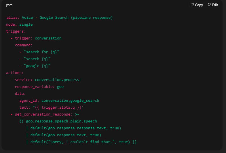

I had GPT 5 write me an automation. Here is my automation YAML.
This is awesome. I was running a script that took up to 15 seconds to respond. I’m down to 2 to 3 seconds tops with this automation now.
