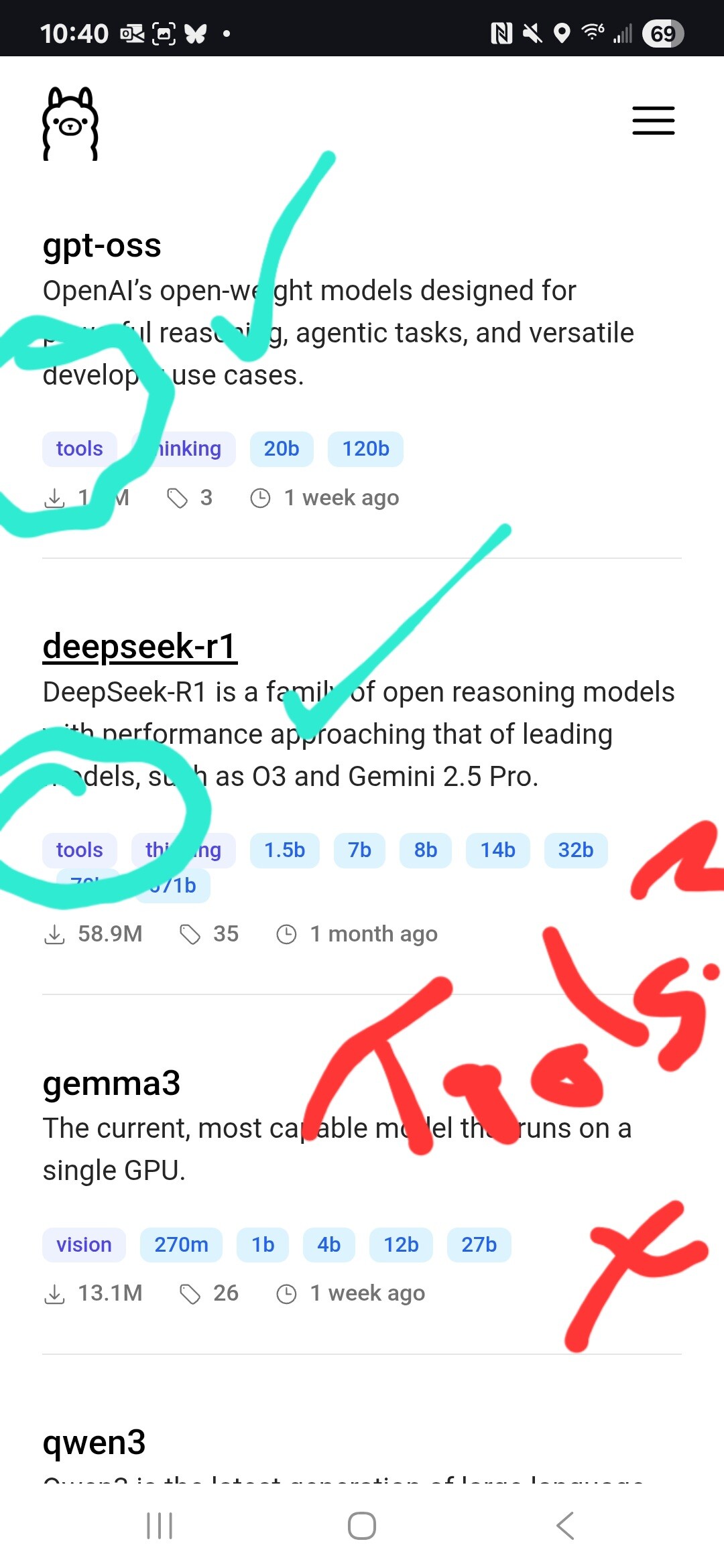

It very much matters. I didn’t think Gemma3 was a tool user.
Ollama.com agrees.
Try something like llama3.2 to make sure tools works
If it does then your model choice is the issue (im almost positive - I don’t even have Gemma3 in my farm because of this. No tools == useless to me)
