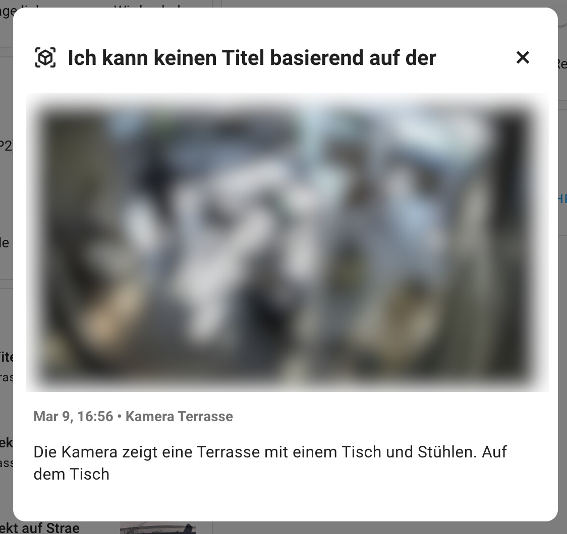

This update looks awesome! Is there a way to diagnose why images aren’t showing up in the timeline card? Events are being added to the calendar and they’re showing up with text descriptions in the timeline card, but I’m not getting the keyframe image.
When I look at the script timeline under changed variables I see:
generated_content:
  response_text: No obvious motion detected.
  key_frame: /config/www/llmvision/46c782f3-0.jpg
That image exists inside that path (I can view it from the file plugin editor), but it’s not showing in the card.
I did notice the documentation says " expose_image" but the YAML configuration offers expose_images. I tried both and only expose_images seems to show the key_frame in the generated_content variable, so I don’t know if that matters.
Edit: I set up debug logging and I don’t see any errors in the logs.
To get this working with image_entity, I needed to get the name of the camera sub entity from the device ID of the automation trigger. I’m using this to pass the “sub_entity” name to the script:
sub_entity: >-
      {{ device_entities(device_id(trigger.entity_id)) | select('match',
      '^camera.*sub$') | list | join('') }}
That results in something like “camera.living_room_camera_sub” depending on the trigger. Then in the script, I use:
 image_entity:
    - "{{ sub_entity }}"
And now my images are showing up in the timeline card.
