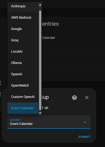

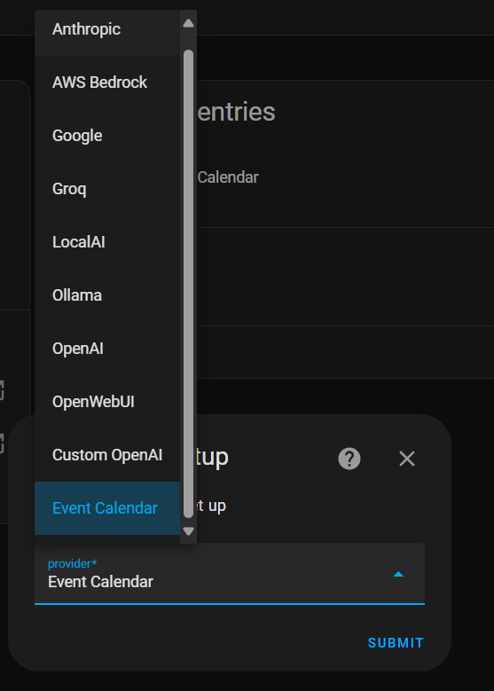

How can I setup the Memory feature? Memory | LLM Vision | Getting Started
Hi @MicNeo !
Just add a new LLM integration and choose Memory in the list
Its not showing in my list either - In fact I don’t have Timeline OR Memory…
I’ve been trying to add it for the last hour. Looks like there may be some kind of issue. (Yes, I updated LLM Vision yesterday because I saw it was a feature of the latest builds)
@valentinfrlch known issue?
It is in beta (v1.4.0). I have now marked it as such in the docs.
Ahhhh yeah that was not apparent at all in the docs. ETA? (read am I going to blow anything up running this beta, heck with it - the ability to edit the motion detected subject line alone is worth it ; ) )
Thank you! I can’t wait for that feature :slight_smile:

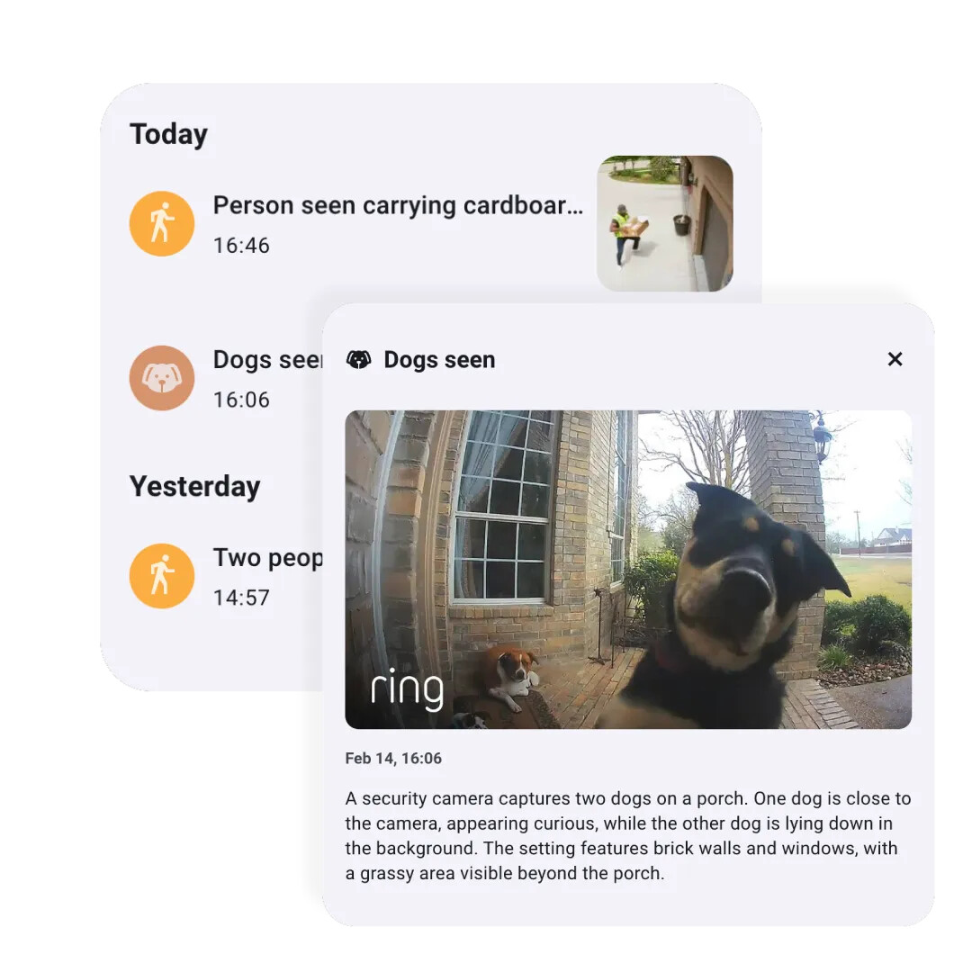

:framed_picture: Timeline Replaces Event Calendar
Introducing the LLM Vision Timeline Card—a new dashboard card to display events. Install it now: GitHub
