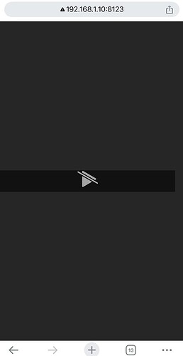

Frigate integration is up and running, but if I access http://192.168.1.10:8123/api/frigate/notifications/1731040278.032353-1ekusx/clip.mp4 then I am getting a play button with a strike through it (see screenshot)
Not sure but it might be related to the Frigate beta. In the release notes of 0.15.0 beta 1 they mention that they migrated to a new API (FastAPI instead of Flask) so I think this is likely the problem.
v1.3 of the blueprint seems to have a few issues.
I have updated and hopefully fixed them in v1.3.1 (still in beta). Feel free to test and provide feedback.
