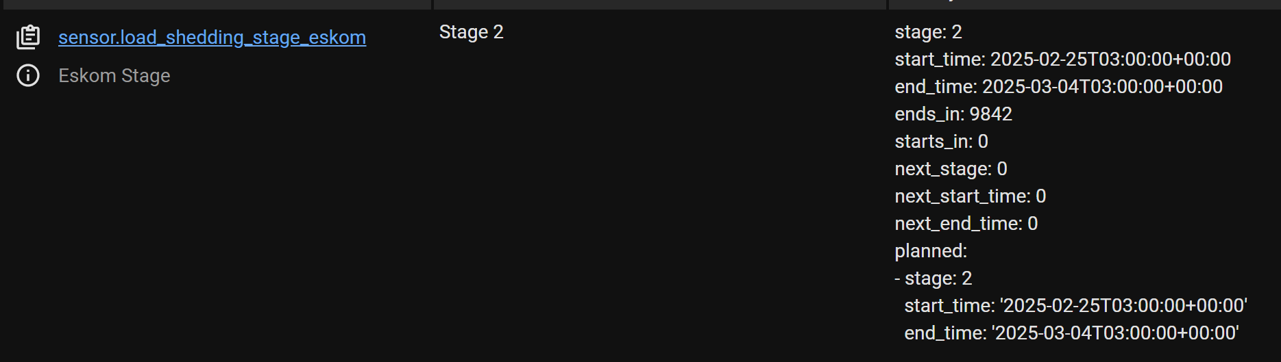

I would like to hide loadshedding related cards in the dashboard when there is no load shedding.
Since the sensor.load_shedding_stage_eskom sensor provides the current loadshedding stage in an attribute, and attributes can’t be used as a condition under the Visibility tab of dashboard cards, is there a workaround to hide/show cards according to the current loadshedding state? (I.e., only show card if Loadshedding stage > 0)
Or would it be possible for the developer of the loadshedding integration to add a sensor providing the current loadshedding stage as part of the sensor state (I’m not sure what the correct terminology is)?
Thank you
