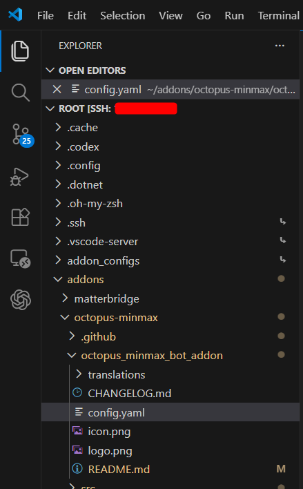

As the title says, I’m trying to create an addon for HASS and I’m following the official tutorial, but even though I create the folder structure and copy the files over it refuses to detect the addon.
You can see from this image that the files are where they’re supposed to be, but it doesn’t work. What am I doing wrong?
Screen Shot 2021-11-02 at 10.50.13
I also followed the tutorial and my add-on doesn’t show up either.
I used the SSH option to create my add-on.
I have the same set-up you have in your image.
Did you manage to get it to work in the end?
Update: The add-on showed up when I rebooted the host system. I’m running HA on an Intel NUC.
Maybe this can be added to the tutorial?
I think pressing CTRL+F5 on the Addon page can solve the problem.
