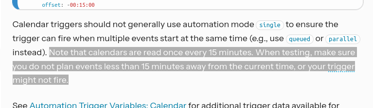

UPDATE:- So google is suggesting that new events made, that are less than 15 minutes from their start time might not fire correctly. Not sure why this is the case when the entity is showing the event data correctly, before the trigger time, but I’ll test that and see what happens.
UPDATE:- Seems giving it more time between the event creation and it then being used as a trigger for an automation has worked.
