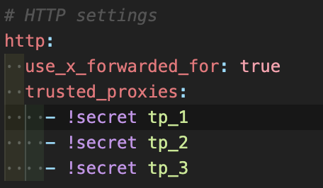

I’ve got a pretty similar setup and it’s definitely doable. I agree with koying, some screenshots of key settings would probably help quite a bit. If you already have this working for other servers you’re likely 95% of the way there.
You already mentioned the use_x_forward_for and trusted_proxies values for Home Assistant, and from what I can remember those values were the main thing I had to fiddle with. To confirm what’s working for me:
  • I’ve got three trusted proxies. The first is the pfSense interface IP for the subnet Home Assistant is on. I also use Cloudflare, so the other two are cidr ranges for where those requests come from. I don’t think those ended up being necessary though.
    Screenshot 2024-06-14 at 9.31.34 PM
  • It’s not really specific to Home Assistant, but I also have a couple shared frontends in HAProxy that each map to multiple back ends. When that config is working for pre-existing servers, but not a newly added one, I often find myself double-checking the back end config. Unless you’re also using a cert between HAProxy and Home Assistant (doesn’t sound like you are), the SSL checks should be off, and the port should be the Home Assistant default:
