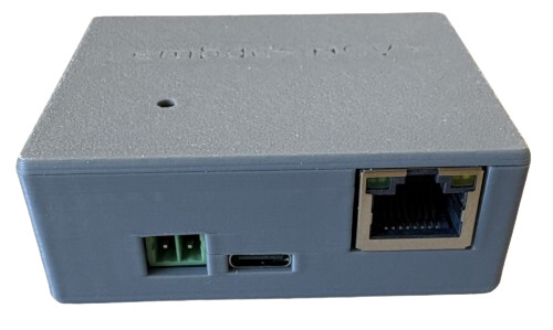

Hello everyone,
Tired of the official ViCare Cloud API limits, connection drops, and internet dependency for your Viessmann heat pump? I was too.
To solve this, I developed a compact hardware adapter that reads data locally and purely passively from the CAN bus of Viessmann E3-generation heat pumps (e.g., Vitocal 250-A, 252-A, etc.) and streams it via Wi-Fi as a structured JSON payload to your MQTT broker.
Since I highly value the open-source community, I decided to go with a hybrid "Open Hardware / Premium Software" approach:
:hammer_and_wrench: For the DIY Makers (Open Hardware):
The schematics, PCB layout (featuring full galvanic isolation to protect your expensive heat pump!), and the Bill of Materials (BOM) are completely open and available on GitHub. You can order the PCBs themselves (e.g., via JLCPCB) and solder them your own. A 3D-printable STL file for the enclosure is included as well.
:package: For Convenience Buyers (Assembled Hardware):
If you don't want to solder SMD components yourself, you can buy the fully assembled and tested hardware inside its enclosure directly from me for approx. €35 (plus shipping from Germany).
:laptop: The Firmware & Native Home Assistant Auto-Discovery:
The firmware features a local web interface for easy Wi-Fi and MQTT setup. Most importantly, it supports native Home Assistant MQTT Auto-Discovery. Once connected, all sensors—including flow rates (in L/h), daily energy consumption (in kWh for the Energy Dashboard), temperatures, and binary On/Off states—pop up automatically as a ready-to-use device in your Home Assistant dashboard.
To protect the months of reverse-engineering work that went into deciphering the Viessmann CAN data points, the firmware uses a fair offline license model:
  • A basic version (allows testing the hardware connection and displays your unique ESP32 Chip ID) is completely free.
  • The full version unlocking all data points and HA Auto-Discovery requires a one-time software license of €50 per device (activated offline via a simple license file uploaded to the device's filesystem).
You can find the GitHub repository here: GitHub - chrkir/hcv: Home control modul for Viessmann Vitocal · GitHub
If you are interested in a pre-assembled hardware board or have questions about supported data points, feel free to reply here or send me a PM!

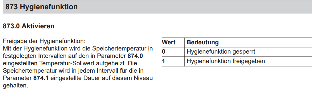

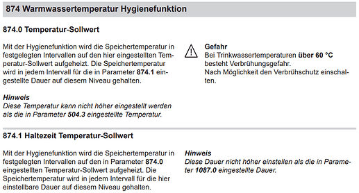

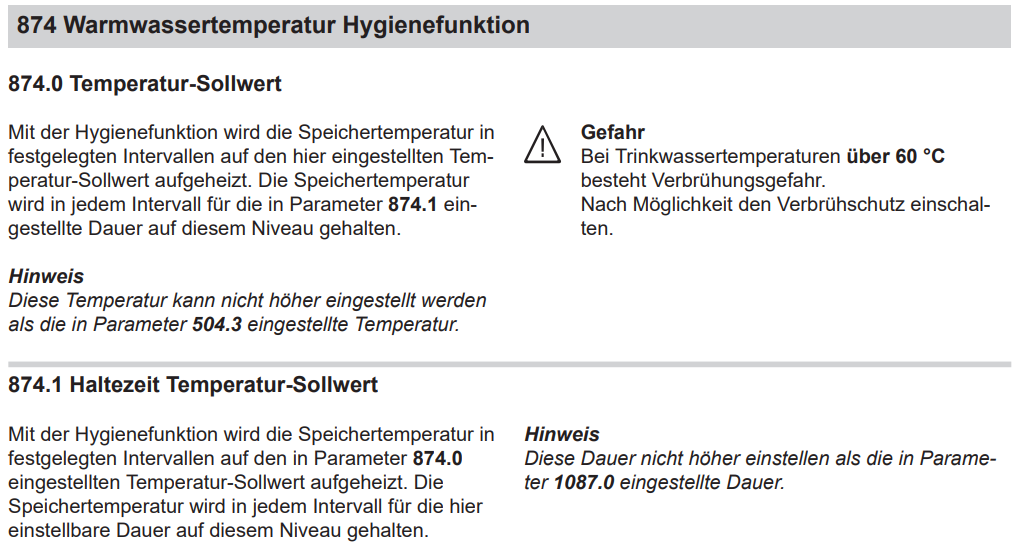

Wie komme ich nun von dieser Auflistung zu einer gültigen Definition in der vcalobj.did?
Warum sind die meisten Werte nur read_only (acc=“ro”), im HMI kann ich die Werte doch auch einstellen (zumindest 875 und 876)?
DIDs wie 874 mit mehreren Unterdatenpunkten 874.0 und 874.1 sind noch zusätzlich mit eckigen Klammern “verschachtelt”.
Dann gibt es wiederum DIDs, die in der O3E-Datei verschachtelt sind, in der Viessmann-Doku aber nicht - wie passt das zusammen?
Weitere DIDs sind in O3E definiert, tauchen aber bei Viessmann nicht auf: bspw. 877 oder 878.

Hallo zusammen,
viele von euch haben nach einer festen Kabelverbindung gefragt, da Wärmepumpen und Speicher oft im Keller stehen, wo der WLAN-Empfang nicht immer optimal ist.
Es gibt ein wichtiges Hardware-Update: Den ESP32-HCV Adapter gibt es ab sofort auch als Ethernet & WLAN Edition mit integriertem RJ45-LAN-Anschluss!
:glowing_star: Was ist neu?
  • RJ45 Ethernet-Anschluss (LAN): Direkte Kabelverbindung zum Router/Switch für maximale Ausfallsicherheit und stabile Datenübertragung.
  • Dual-Option: Kann wahlweise per LAN-Kabel oder wie gewohnt über WLAN betrieben werden.
  • Ideal für den Heizungskeller: Kein Verbindungsabbruch mehr durch dicke Kellerdecken oder geschirmte Heizungsräume.
  • Voller Funktionsumfang: 100 % lokal, cloudfrei, galvanische CAN-Bus-Trennung und native Home Assistant Auto-Discovery.
:date: Lieferbarkeit & Details:
Die Ethernet-Version ist ab dem 1. Oktober lieferbar.
Bei Fragen zur Einbindung oder Hardware stehe ich wie immer hier im Forum zur Verfügung!
