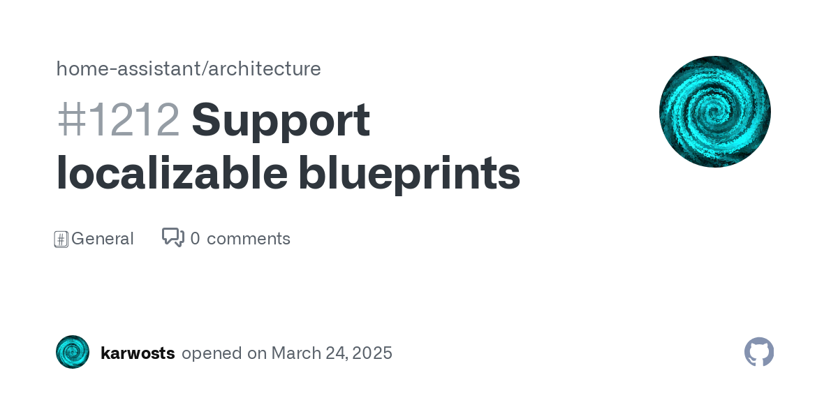

I haven’t filed an architectural proposal yet, was a bit hoping to see a little more interest from the community before I take a proposal to the core maintainers, as I’m sure they will want to see the same thing.

As long as we’re on the same page about that, I can go ahead and ask in an architecture discussion about moving forward with that. I’m not sure if that’s sufficient for what you’re asking for.
