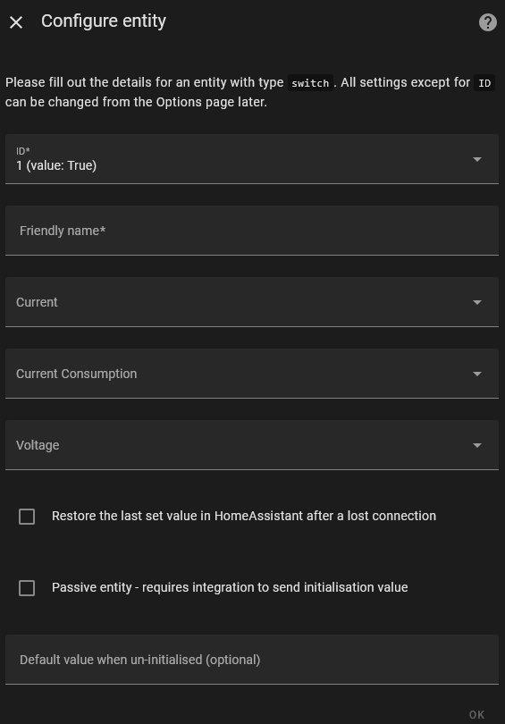

@Dax1900 can you explain in a bit more detail how you did this? When I add my smart plug, I am prompted with this config window in the local tuya integration:
According to your description above, I’d have to set Current to 18 (value: 0) and Voltage to 20 (value:2414). I guess the value for Current is just the currently measured value for current (zero, because turned off?) and the value for voltage is ~240V *10?
“Current consumption” would then refer to the power draw and would have to be set as 19 (value: 0)
If I do this, then I do see Current, Voltage and Current Consumptions as Attributes of the switch, but they are not present as sensor entities :thinking:
