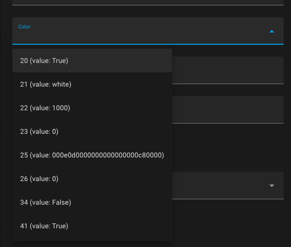

Here is a screenshot of the LocalTuya adding dialogue:
…and of the dropdown of the choices:
I will add the extracted tuya schema for the bulb on the very bottom.
I am wondering what the first textfield is telling me. It says “ID*” and is filled with the value for “20” : “Switch_Led” - and the switching is working, so this i smaybe a UI bug?
It is unclear to me what to configure for “color mode” and “color” and “scene”?
If I add my scene_data to the scene field, I see scenes and i am able to switch them, but then th iu switches from color temp to color picker and the brightness control is not working anymore…
Edit: I now know why its not working anymore when selecting the scene switch. My bulbs are not RGB or RGBWW, but just white with temp. localtuya suggests otherwise with the scene presets:
