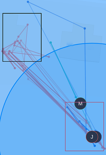

For most of the time so far my location has been reported exactly at my house premises (black frame) only with very occasional jumps. Thought about jamming but is it likely if while any GPS app is active, location is fixed and reported correctly on map in matter of seconds? Also drift is always in the same direction, I presume with jamming on it would be more random drift?

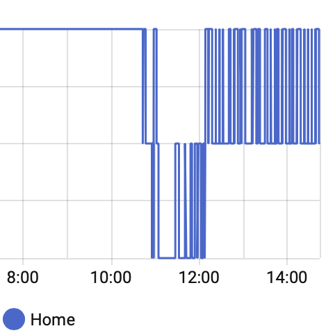

Below is a history graph of zone.home. We left home at 11, went well beyond the home zone and returned at 12.
It sounds like you have defined a zone that overlaps with your home location. You should not define any zone for home, this is done by HA automatically.

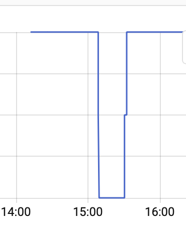

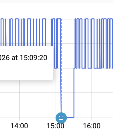

Couple of history graph excerpts below. One shows number of people in zone.home; the other in my own myzone.home template derived from iCloud3 tracker entities.
All other devices running HA app are stationary at home (3 Macs) - their trackers are not listed in People Page.

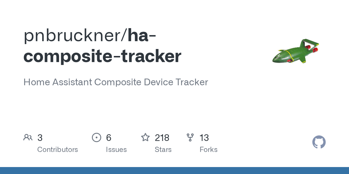

You might also want to try composite integration. It has another approach to combining multiple trackers to one.

Despite this, the mobile trackers continually bounced in and out of zone.home like a yoyo every 3-5 minutes! The iCloud3 tracker, on the other hand, remained rock solid and accurate. Both mobile and iCloud3 trackers were enabled under “People” but the iCloud tracker is completely ignored by zone.home, it seemed to follow only the mobile tracker. Removing the mobile device_tracker from a Person and leaving only the iCloud tracker made no difference.
I then decided to delete all extra zones other than “Home”. These were concentric zones around home to give multiple geofencing options. Bingo, all the jitters stopped.
Thus I have changed my automations to initial Home and Away automations dealing with entering and leaving the home zone and, rather than fiddling with more zones and configuring entry/exit triggers, I have rewritten the rest of the geofencing automations in terms of “distance from home” rather than being “in a zone” and, so far, these are working as expected. The logic is simpler anyway…
