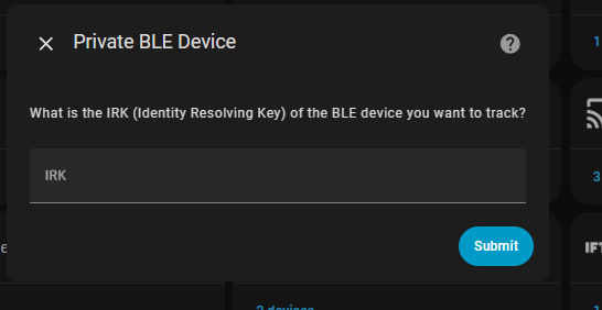

BLE requires the IRK to connect:

@tom_l thank you Tom and others here, I have the location tracking (Home/Away) for each the person now working for four entities for each of us. The above method for the BLE IRK was incorrect, I have posted al my details and the results below. The four entities for each person I am using are three types:
  • GPS (through the Home Assistant App on each phone)
  • BLE (through the “Private BLE Device” integration for each of our phones)
  • Router (through the Official TP-LInk Integration)
  • Router (through the HACS TP-Link Integration)
Notes to get this to work most easily:
  1. For the WiFi (router) portion, due to my WiFi setup here to ensure there is no issue, all phones involved have to stay with one WiFi SSID, have a static IP address, and have static MAC addresses. It appears that even if your router keeps the IP the same for the device with a radndomized mac address that will not work as both TP-Link integrations I am using - HACS (which has many moire attributes exposed) and Official - they both rely upon the Mac address as an entity identifier.
  2. For the BLE setup to get the IRK for each phone (android and IOS), the easiest way to obtain it (for me) is to temporarily connect to teach with a Windows PC (you need administrator rights). Private BLE Device - Home Assistant

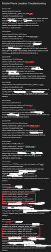

For testing purposes, I have set up a markdown card (screen shots and code below).
The card is realtime dynamically sorted (newest activity on top) and shows the cell phone related inmformation for testing purposes - all the details each separated by a blank line only for each location sensor and the people sensors. I have it set to show only the items that are “Home” as well. Quite handy! (You have to click on the image to be able to read it.)

It is now working properly. The most important thing, that the wife’s status changing to home (even with an iphone that is in a purse and asleep, not used for hours) - works very well. As soon as she gets near the house - her status now changes from not_home to home. Rock solid. Our phones are relying upon 4 sensors which are all working properly to make everything pretty sold - GPS, BLE, and ROUTER (two: a native TP-LInk Integration, and also a HACS TP-Link integration). So thrilled!
