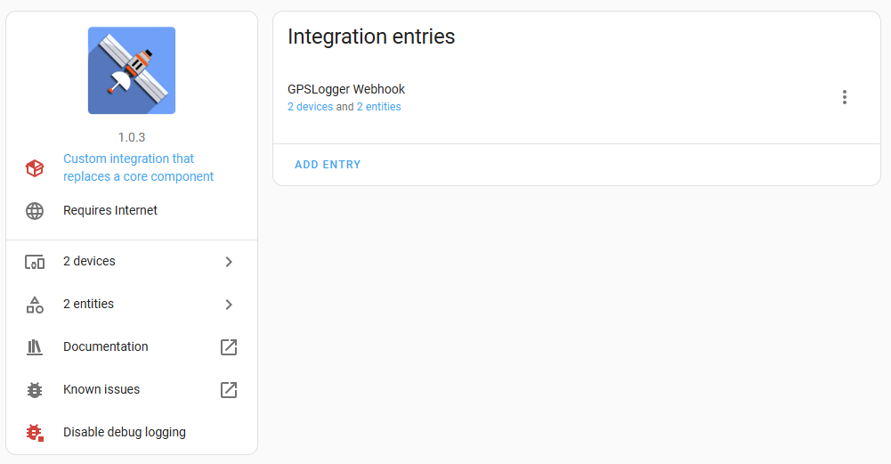

If you go to Settings → Devices & services → GPSLogger, what do you see for devices & entities? E.g., in my system, I see this:
I see two devices & entities because I used it with an older phone, then used the same URL/webhook on a newer phone. I just haven’t gotten rid of the older entries. You should see one device & entity I would think.

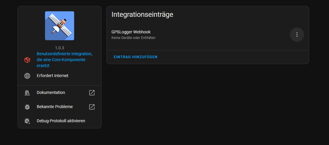

I thought that I have to see devices or in my case one device, but my integration is “empty”, no devices added.
I dont undertand why the webhook ist working but the GPS Integration doesnt recognize it so that IT creates the device_tracker.
I dont know whats wrong.
