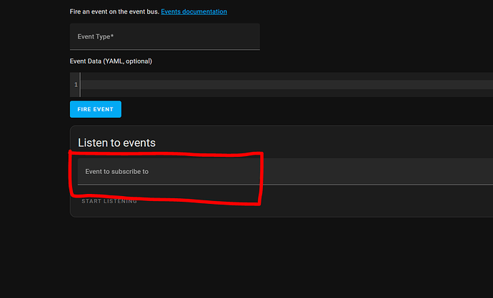

Go to developer tools → events.
I guess you need to listen for deconz. Have a look in the list to the right.
Press listen and you should see the events from the switch.
Thanks, but nothing is displayed.
I have logbook_entry as the event type and “deconz” for the listener

There is only one field to listen to. How can you have two entries?
