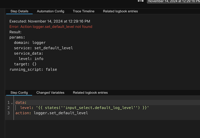

Anyone else running into trouble w/ this all of a sudden? Seems like set_default_logger isnt supported any longer
alias: Testing Log change
description: ""
triggers:
  - event: start
    trigger: homeassistant
  - entity_id: input_select.log_level
    to: null
    trigger: state
actions:
  - data:
      level: "{{ states('input_select.default_log_level') }}"
    action: logger.set_default_level
  - data:
      logger: "{{ this.entity_id }}"
      level: critical
      message: >-
        ***** HASS LOG LEVEL SET TO : {{
        states('input_select.default_log_level') }} *****
    action: system_log.write
yaml parse error in a logger filter the issue… all good now

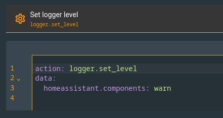

I just ran across this and would like to know if this still works today in some form and if so, and someone using it sees this, could you please post your config and any automation examples please.
Works for me with a few changes over the years (actions, data_template, …).
# logger config
logger:
  default: warn
# input_select, only for setting, doesn't reflect the level if changed from another place
input_select:
  log_level:
    options:
      - critical
      - fatal
      - error
      - warning
      - warn
      - info
      - debug
      - notset
# automation
automation:
  - alias: Log Level
    triggers:
      trigger: state
    actions:
      action: logger.set_level
      data: # works also with data_template but is deprecated
        homeassistant.components: "{{ trigger.to_state.state }}"
If you want to test/set it from Tools > Actions (YAML Mode)
