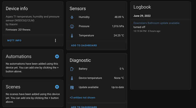

I can see some of my Zigbee devices - e.g. Aqara WSDCGQ12LM, and it is pulling sensor data:
My question is around history or logging of the sensor data - is there some way to enable HomeAssistant to log this data (e.g. temperature/humidity) over time? How do you view this?

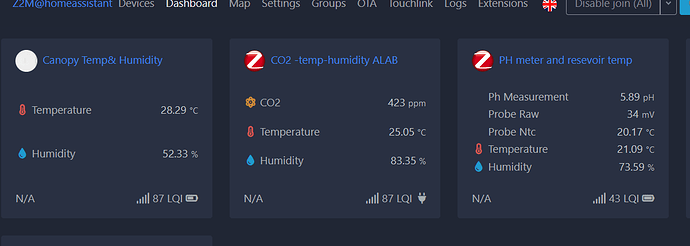

I cannot “find” my zigbee2mqtt logging data . I used to use ZHA and it automatically displayed my logged data in a nice graph,
I would like to see the zigbee2mqtt data in a graph.
The picture with “current” data is all that I can find…

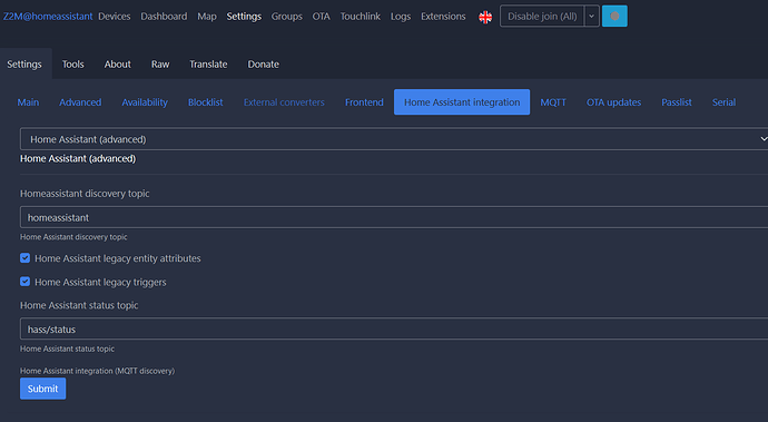

You are looking at the data in the Z2M dashboard, this is only there for creating a overview when handling the zigbee network. All the information is stored in HA, just as for ZHA, in entities. You will have the same posibilities.
If you can not find the devices and entities in HA, then something is wrong with MQTT setup

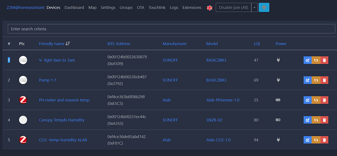

The Devices are all recognized in Zigbee2mqtt with good LQI (see this screen shot)
And I get sensor Readings, and can operate switches in Z2M but not HA>Overview

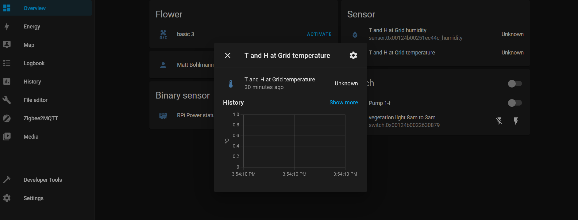

Vegetation light can be controlled in Z2mqtt no problem…but on the HA dashboard It has The lightning bolts(see blue circle in prior post) instead of a on/off and the automation fails to act ?

This Sonoff Temp and humidity sensor is on my dash board but both T&H say “unknown” instead of displaying the T&H . I can view the T&H in Z2M and I can watch them respond. so zigbee is communicatiing. I will try re-pairing
As it works in Z2M, i do not believe it is related to zigbee. You mention your MQTT setup are a external. Are you sure Z2M connect correctly to this? That it populates correctly to MQTT? Do you ave other MQTTD3vices in HA working correctly?
The sensor in your screenshot, was that created by Z2M? Or is it from when you used to use ZHA? Since you said you switched from one to the other right?
The empty graph is in HA dashboard (black backround)
All sensors read accurately and switches work in Z2M (blueish screens)
Even though all sensors and switches work in Z2M they are not showing up in HA>devices
