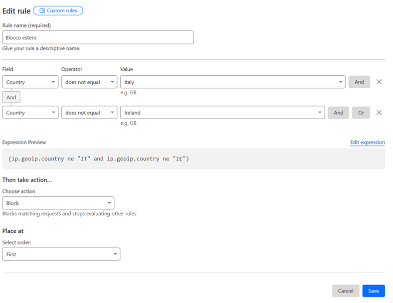

Hi all, I try to describe all the step to be followed.
First of all login to your dashboard inside Cloudflare and select the domain you want to filter, then the steps indicated bleow allow you to create your own rules.
this is the rule that I’ve created that block all the IPs coming from countries different to Italy and Ireland. (please note that I added also Ireland to continue to use Alexa with Hasska method)
in addition my suggestion is also to add the ip-ban inside the configuration of Home assistant as follow to avoid possible unfiltered attempts::

Thanks for your effort. :+1:
Have taken a look at the steps, also on Cloudflare and seems not to be to complicated. So will give it a try soon.
Ip_ban was already enabled but threshold was 5. Lowered it to 1.
Have implemented the rule in Cloudflare WAF and seems to work for me. In more than 24 hours I didn’t receive any ‘Login attempt’ messages. Living in the Netherlands, only nice people here :wink:
