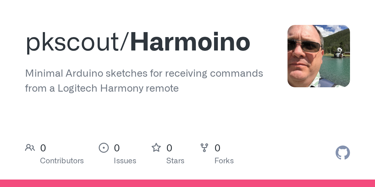

Here is what I’ve been using with a Harmony Companion:
What a great find. I don’t know what internet search foo I lack, but in all my hunting I never found that. I ordered some of the radio components and grabbed an ESP32 board I had laying around and got it all working today. That Harmony companion remote is still probably one of the best remotes I’ve ever used, and I’m pretty stoked to be able to use it again. I have two of them (and the hubs) laying around, so if one fails I still have another.
I forked the repo and created a code file that will create a device in HA with a sensor for key presses that makes it a bit easier to integrate into HA. I’m going to see about writing up some instructions tomorrow.
