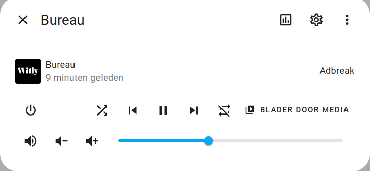

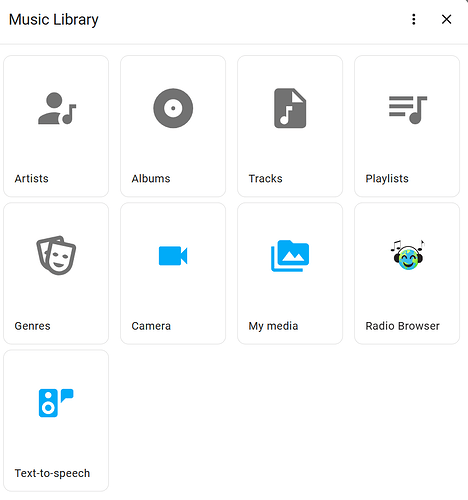

In HA i see this when i let the LMS plugin add the different players and i select one:
And in here, if i select “Browse Media (Blader door Media)” i cannot see my LMS “favorites” or “my apps” like i have on the players or via SqueezePlay.
Anyone using the HA LMS integration knows if this is possible?
No at the moment lms favorites are not supported.
