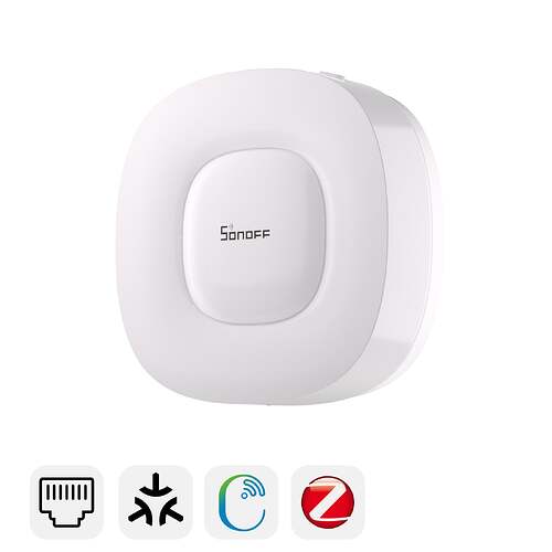

The first one seems to work with Zigbee Sonoff devices only and seems to require cloud access (see ), which I’d like to avoid.

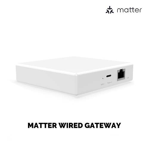

The second one seems to work with Tuya (only?) but it’s unclear how that would integrate with HA.
From what I can tell:
  • The Sonoff Bridge Ultra might only work with Sonoff Zigbee devices and seems to need cloud access Difference between SONOFF iHost and ZBBridge Ultra), which I’d really like to avoid
  • The Moes/Tuya hub looks like it’s more for the Tuya ecosystem, but it’s not clear how well it plays with Home Assistant.
