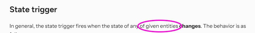

https://www.home-assistant.io/docs/automation/trigger/#state-trigger
If you don’t give it entities then it is not going to work. Thus - not optional.
For me, an empty list means optional, and as I said, no error is thrown. So the validation must be buggy.
